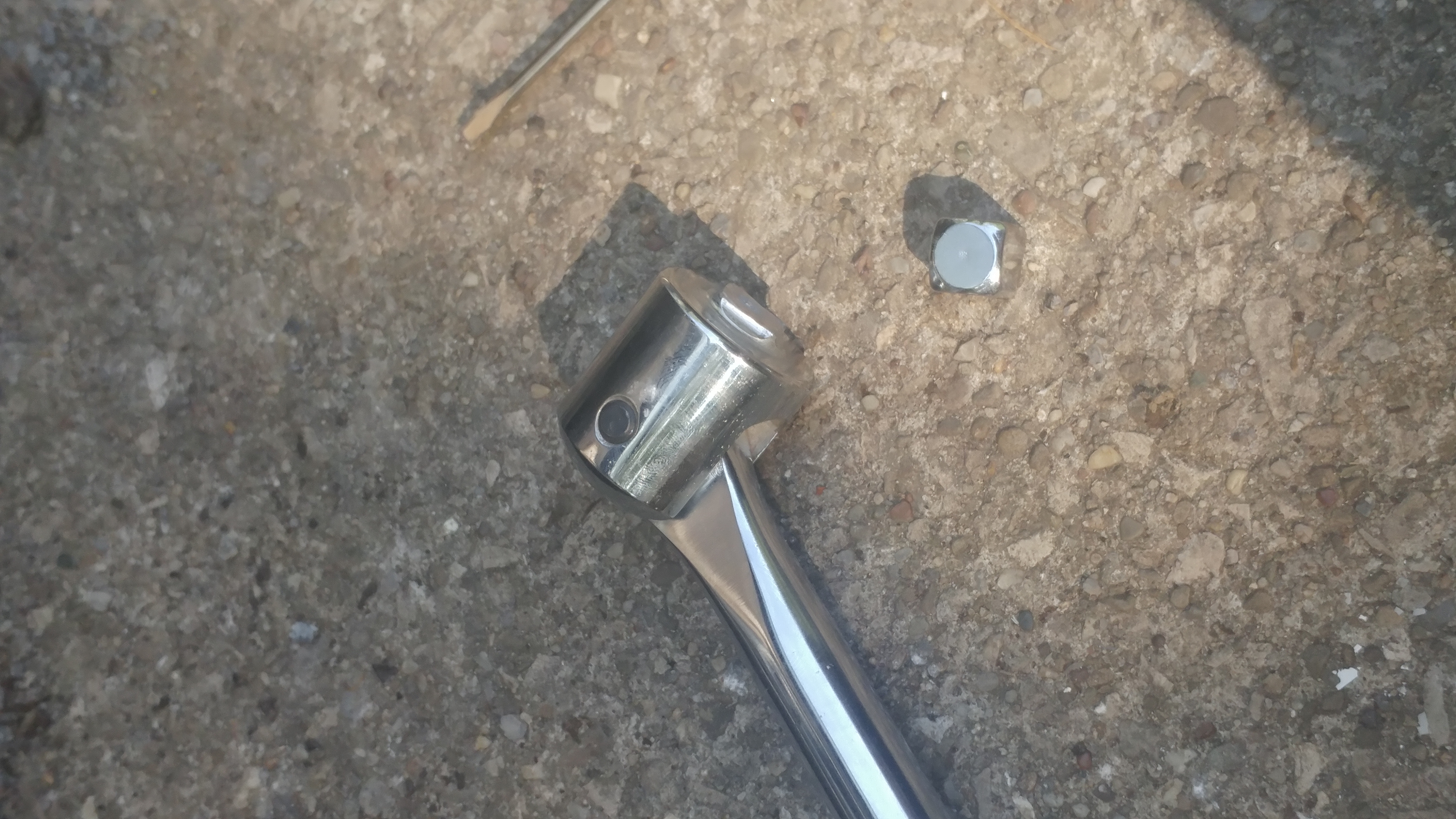

6 hours of hitting my rear axle nut with everything I've got and this happens :lol:
Been there ;) I have a 6ft extension for my 3/4 in breaker bar. Have had instances where that was not enough. Had to use torch.carefully. If you have access to a shop with a 3/4 or 1 in impact,you may want to take it there to break it loose. This is not uncommon. You may be the first person to try to get at the rear brakes since 1977. not :o

That tool was my next step. However I got a sliding breaker bar and a 6 foot cheater and that did the trick.

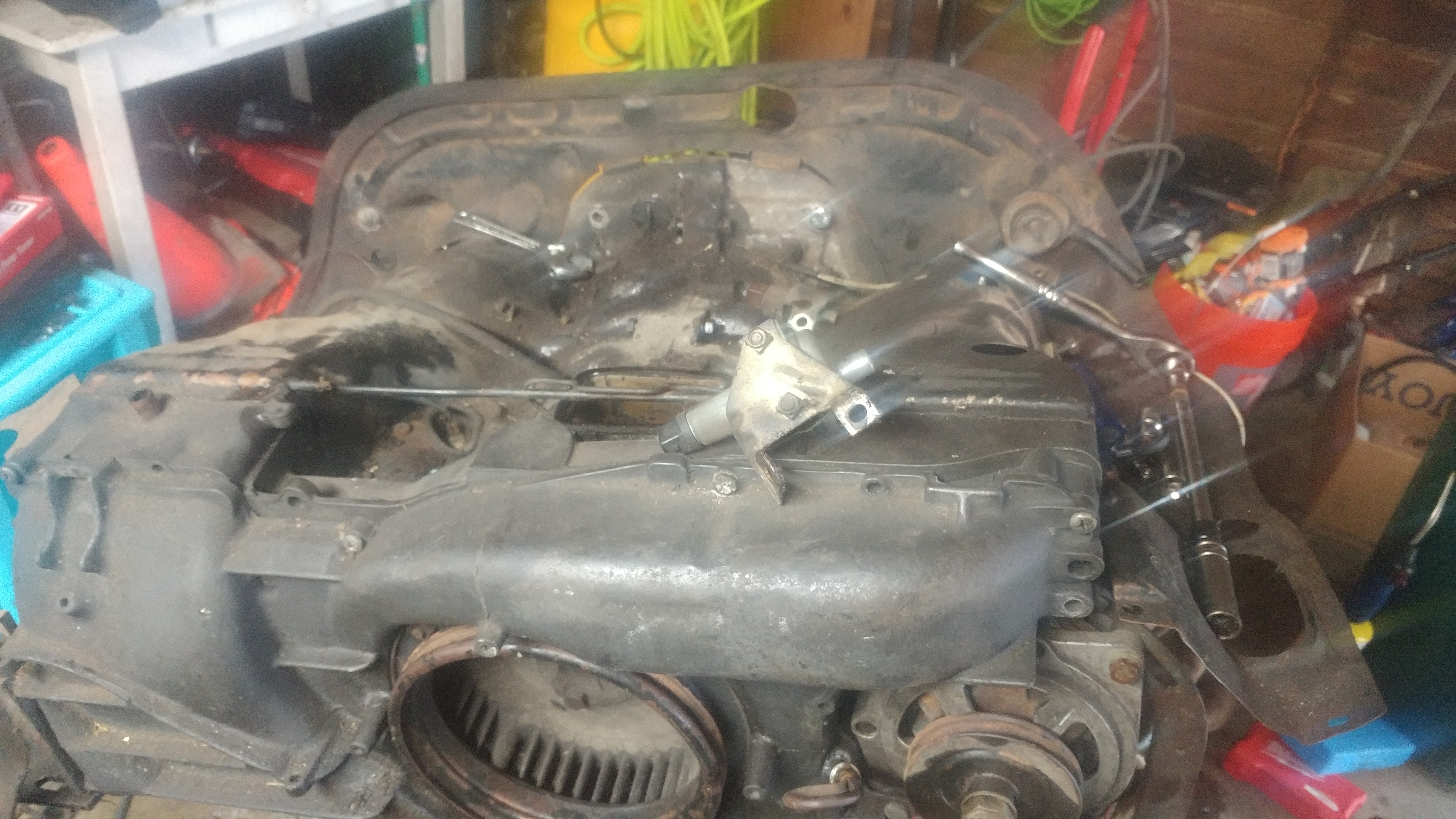

Started tearing down the engine this afternoon. I think I've had to cut every bolt out of the exhaust so far. Also some of my studs were missing.
Confirmed i do have the GD engine with round ports.
Have a couple screws holding the cooling tins on that are stripped, but i hope to have the engine stripped down to the longblock tomorrow.
I need to buy a new thermostat.
Thanks to Rick and Dan (i think, still learning names) for the tip on ATF and acetone instead of pb blaster. Worked great.

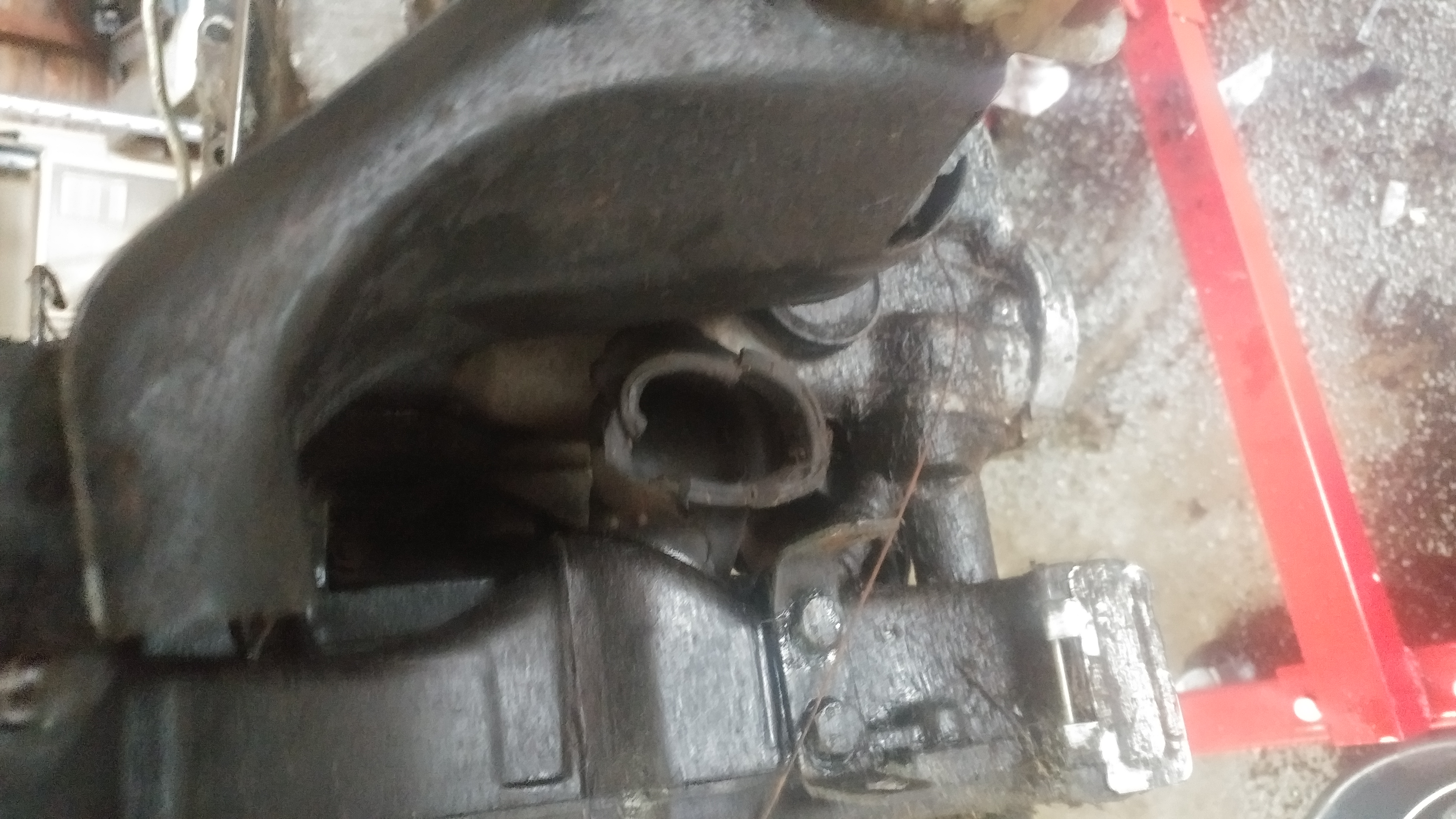

What is this black boot or hose? It is broken. If you cant tell its behind the alternator.
Posts: 315
Alternator boot, lil rubber boot that often needs replacement:
http://www2.cip1.com/ProductDetails.asp ... -903-655-B
assuming yours is for the 55 amp standard alternator, the 70 amp alternator & matching boot are different:
http://www2.cip1.com/ProductDetails.asp ... 22-903-655
usually the easiest way to disassemble the fan shroud-alternator assy is to just remove them together and leave the alternator attached to the fan shroud, that way you need not disturb the alternator boot, this advice may be too late to help you...
