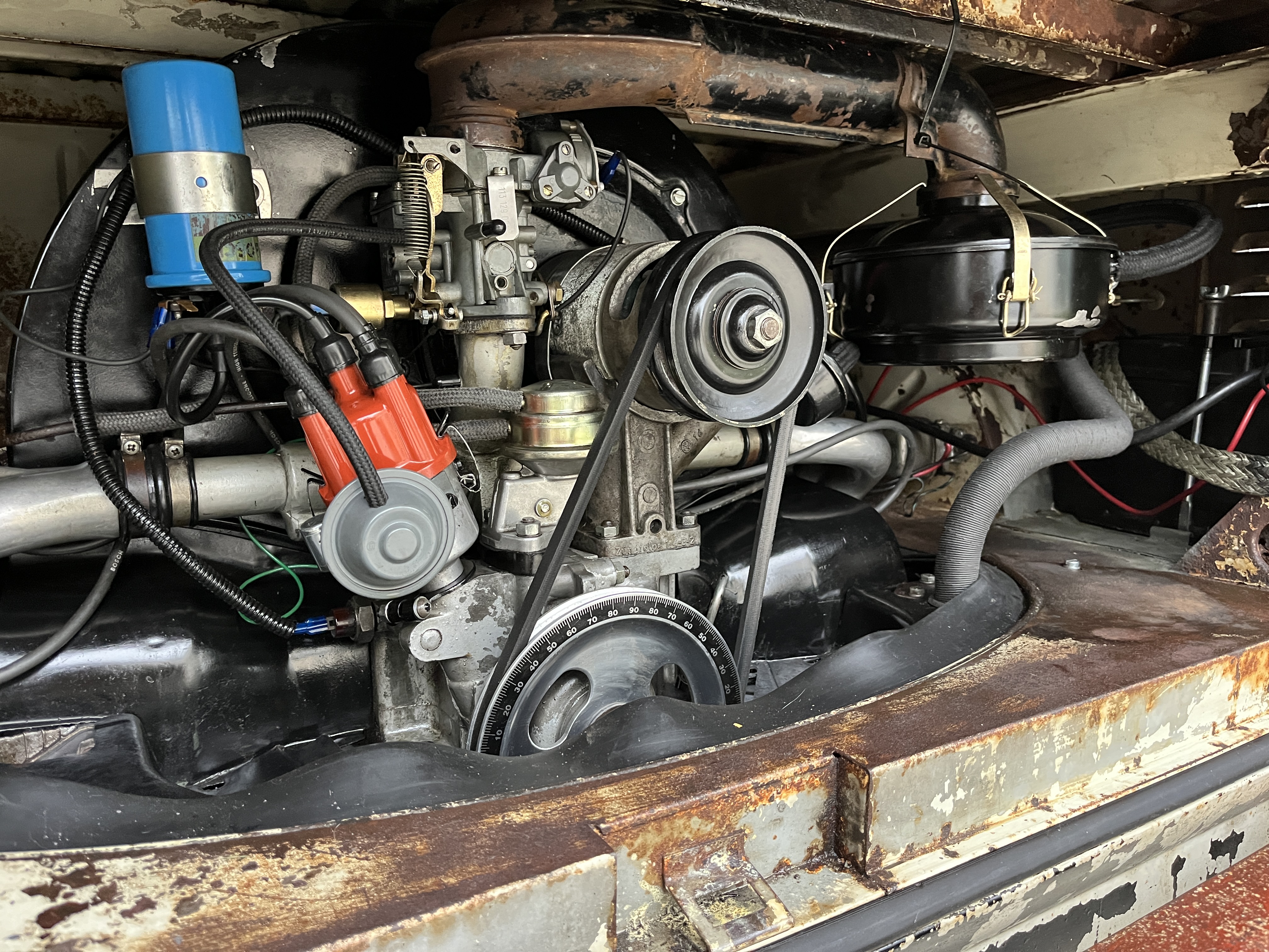

I dug into the oil spray situation I the engine bay. What a mess that was to clean up. Turns out putting some cheese cloth over the oil breather tube just makes the oil spray a mist of oil everywhere. I decided to go with a more stock set up and got myself an oil bath air cleaner. I wasn’t able to get it to fit going to the left side so I mounted it going to the right. I ran a new preheat hose, had to punch a hole in the tin and a hose to the oil breather tube to catch the oil spatter. Ran it for a little while and it seems to have taken care of it.
Also, while working on the placement of my air cleaner, I noticed the coil was resting on top of a metal gas line. Not ideal. I had to fix the clamp holding the coil to the fan shroud by adding the bolt to make it tight. I added a piece of hose to cover the metal gas line for precaution. I’m wondering if this was causing my hot start issues. I will run it like this and see if it’s still an issue.
