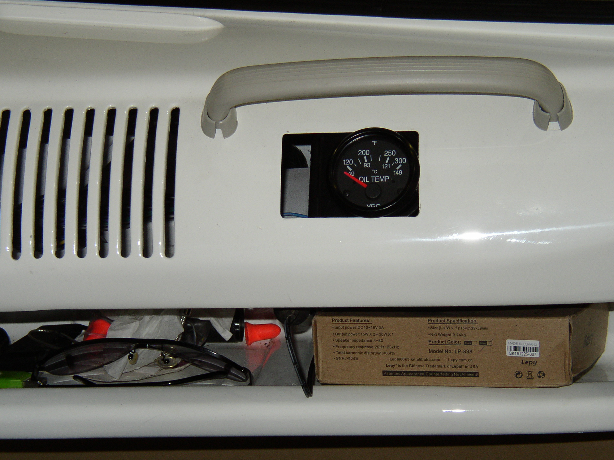

I'm using a VDO oil temp gauge and sender, but compared to a Fluke it reads about 25° higher than the Fluke. The Fluke seems dead on at room temp/body temps.
Here the Fluke reads 196,
And the VDO reads 220ish with both tips of the senders in the sump about 3" apart.
