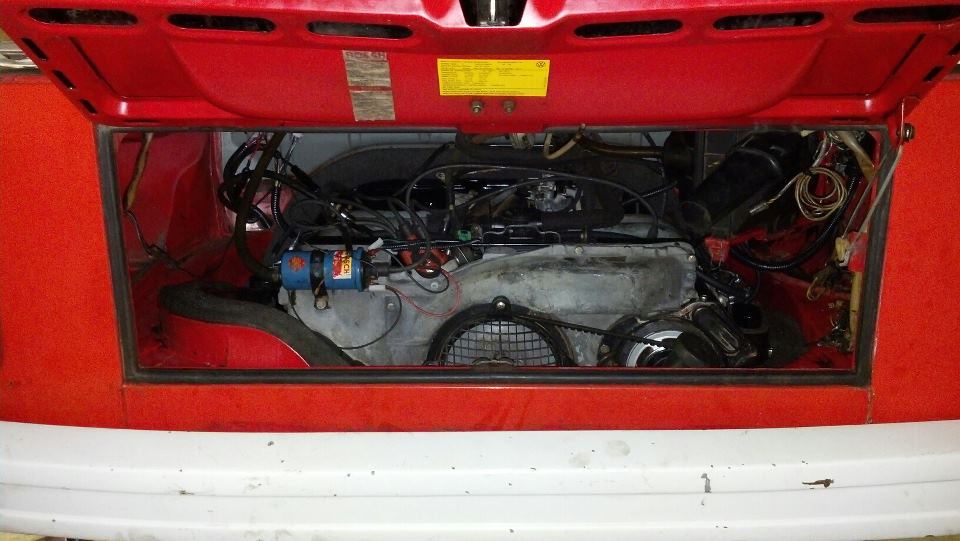

About all the hot engine chatter:
1) Not sure if there was a lean fuel issue, nothing appeared out of sorts.
2) I did not check the timing prior to engine disassembly, and I do not know if it was excessively advanced.
3) Minimal foreign debris around the cylinders, no nests of any kind.

This motor had a top end done in March of 1994. New P&C's Mark Stephens heads this was at 115,337 miles. At 139,294 miles, 7/99 rebuild AFM. Bus ran great for PO who maintained it well
as has Smitty. The timing was right on and is fitted with Pertronix. I strongly suspect a slightly lean condition, not dangerously lean for normal use but lean enough,that under the conditions of this trip accelerated the demise of this motor. The air/fuel ratio,especially on a vehicle as heavy
as a loaded down bus in high ambient temps is extremely critical. It can not be done without the proper air/fuel measurement equiptment and a lot of patience and someone who knows what they are doing.

wwebner wrote: I strongly suspect a slightly lean condition, not dangerously lean for normal use but lean enough,that under the conditions of this trip accelerated the demise of this motor. The air/fuel ratio,especially on a vehicle as heavy
as a loaded down bus in high ambient temps is extremely critical. It can not be done without the proper air/fuel measurement equipment and a lot of patience and someone who knows what they are doing.
+1 on all points after seeing the pics. I know less than nothing about VW Bus injection, and I don't even know if it's a closed loop system using an O2. If it's not, I have a LM2 wideband setup for sale that I used to check the A/F ratio in my engine. It's low mileage and the sensor was never dropped or abused.
I'd suggest an ultrasonic cleaning and flow bench of the injectors to verify flow rate and pattern are correct, I used to have this setup when I had the shop. As for local, I think York Diesel in Medina might still do them. (723-4003?) They could also be sent to Linder Tech in Indy who I recommend highly. www.lindertech.com

Nope didn't break more... didn't have anything left to break, Bill & I are rounding up & preping all the parts to build her engine, I'm planning on having everything by next week, I am waiting to get the rods & cylinders back from the machine shop, Bill is sending the fuel injectors out to have them reconditioned, this week I'll be cleaning & painting all the engine sheet metal, cleaning and doing the final prep on the engine case & major engine components, should have it ready to install around September 22nd... I will keep everyone posted.
