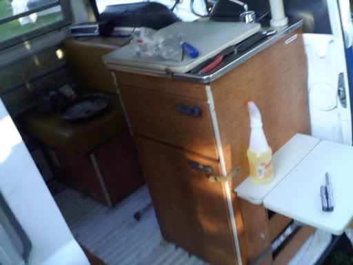

Just any FYI for everybody, the holes don't line up on the aluminum parts from different buses, even if of the same year. The window in the sliding door didn't like to open very well, so I installed the other spare I bought in the fall and it works pretty well, just have to clean it and its twin up. I have a line on another closet of the right veneer, we'll see how that turns out. Hinges are still MIA. The wiring works, wall socket and 68 seat socket are wired together for the time being. The clock radio played Christmas music for us. Their switch and fuse aren't hooked up since we didn't know how to wire them in correctly.

What do you think of the floor sample? It's stuff from Menards.

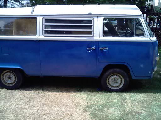

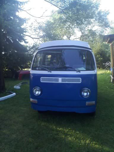

Here are some photos. It was originally pastell white according to the m plate, as is a spare ratty mirror in a box of parts. Need to find my stash of good replacement mirrors! The color change was done by me from who knows what shade of blue by a PO to royal blue, not a great respray due to it being hot that day, (runs/rough patches) but it does the job for now. I may redo it later, or at least fix the runs with 2000 grit wet-sanding.
when picked up
now
still some dents from that damn tire carrier, need a slide hammer puller thingy or more filler before restoring the emblem to it's place....
