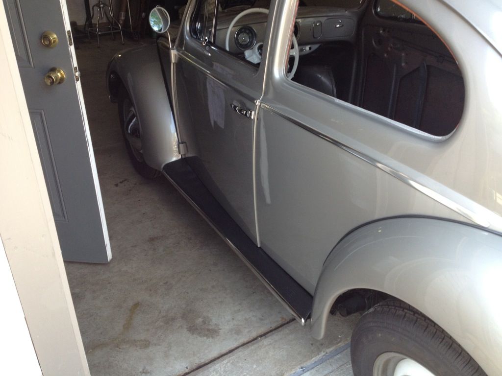

Decided to try WW for the running boards. $96.50 each (ouch). They are pretty nice.

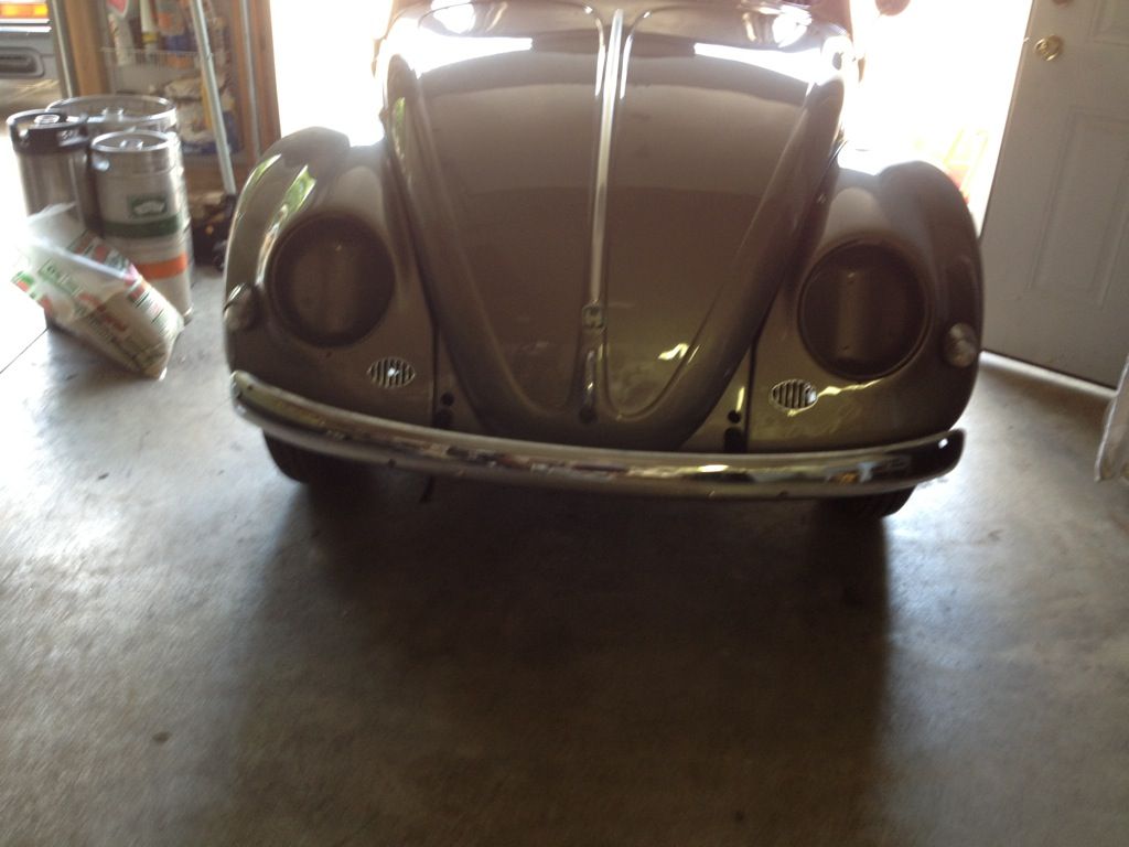

I'm really struggling with this oval. I've been a bit over my head at times. :lol: Finally got the bumper issue squared away with some help from TS & some 'grunt' work. Lights came out great. Front bumper too. (As long as I don't go 12 Volt! :lol: )

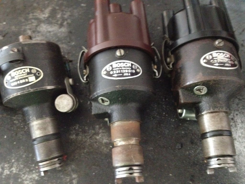

I've really got to decide on some distributor issues. I LOVE the old "cast irons", but I have to decide what my set up will be. Do I go heresey and make it 12 Volt? :shock: If only VW stopped making engines with the 25/36 horse! :lol:

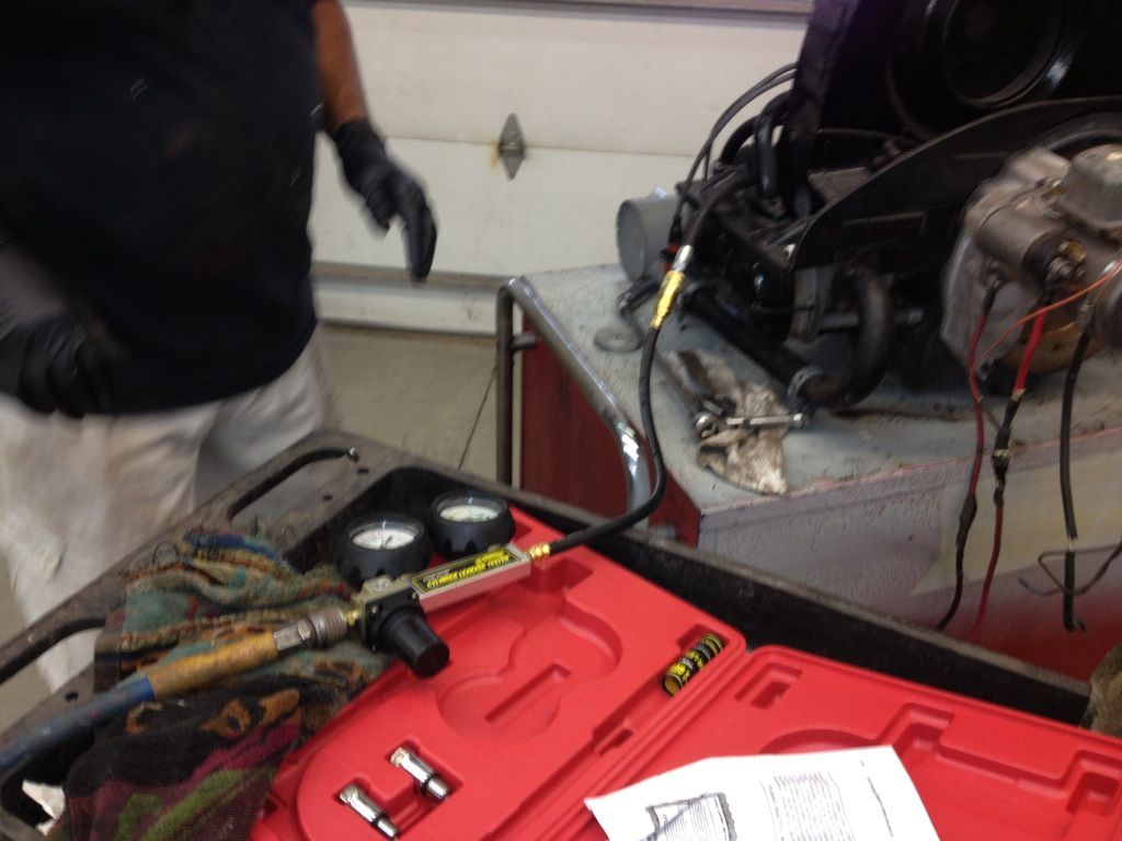

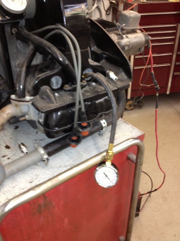

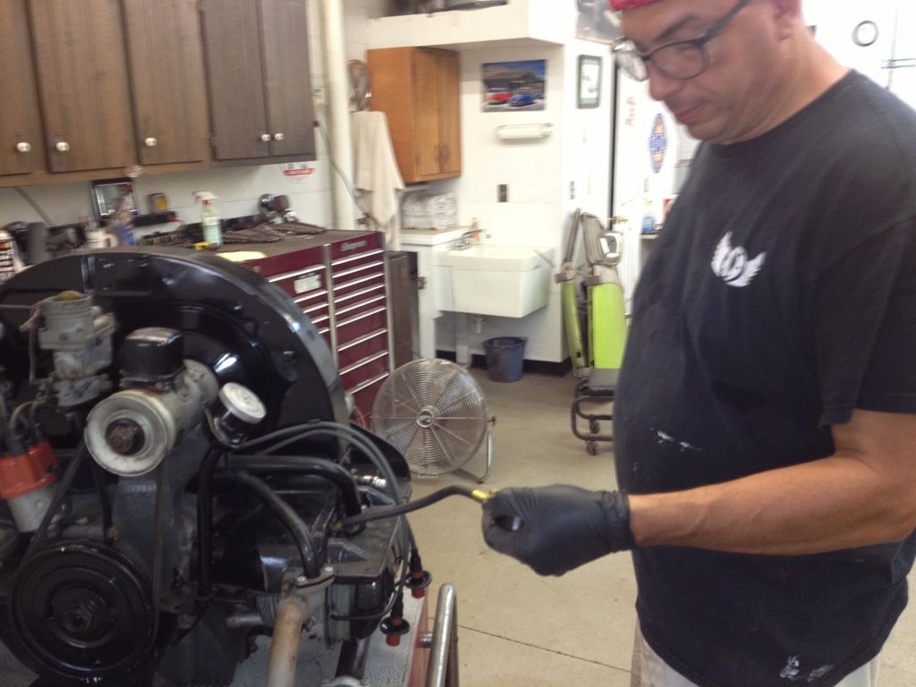

Since I really couldn't say what was or wasn't done, Bruce decided to put the engine through a few tests. We started with a compression test. Some bad news out of the box, but not fatal. #1 101, #2 87, #3 117, #4 110. So #2 is a problem. Bruce took the time to explain to me the leakdown test process then proceeded to do it. I was hoping for a valve problem, but it's coming from the piston/ring cylinder area. Bruce showed me how to listen for the compressed air escaping. I could hear it clearly from the oil cap. What's another rebuild in my life? :lol: Heads seemed ok.

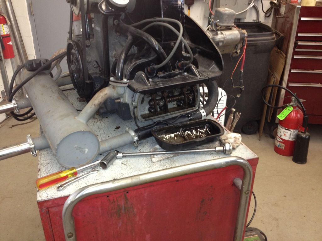

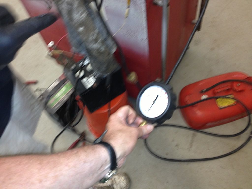

Next Bruce checked the cam lobes to be sure I wasn't running anything worn and they seemed ok. Also end play was checked and while there was some, Bruce said he'd run it as is since it wasn't that much. Engine oil pressure was a 44lbs.

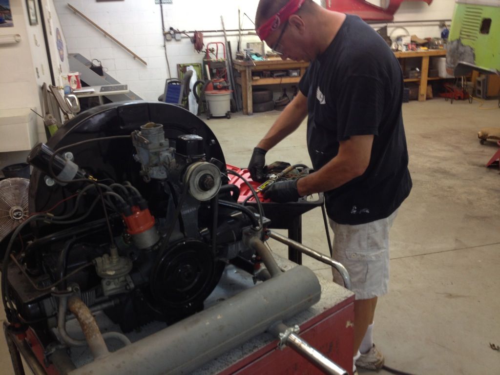

Bruce took the time to go over the timing procedure and TDC location. Again, this was a great refresher course. Bruce explained things in an easy to understand manner that even I could comprehend! :D So much of my learning normally comes from reading, but I've found with mechanical items it's much easier to learn by watching the actual procedure.

Hey, we have to have one blurry picture. :D When tested, oil pressure was at 44lbs.
Leakdown test revealed probable problem with #2 rings/cylinder.

Compression test.

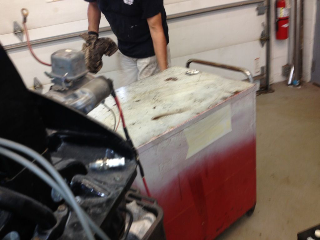

I love this little tranny case/starter unit that Bruce has. More compact than an engine stand.
