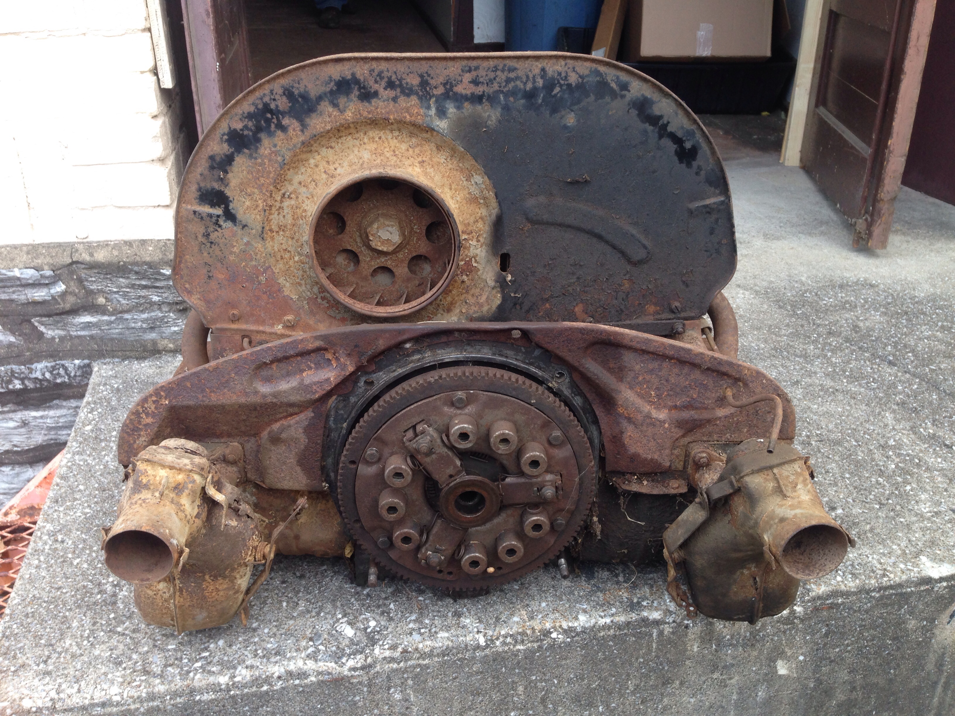

parker beene wrote:I was told it was original to the bus and was a 1500cc but I'm not sure the horsepower- I would guess 40hp.

Guy at the shop today said it looked like a 1300 40 horse and I tried to tell him the block code was from 71' but argued with me
on further look it is only a single port not dual port, but as of right now I think I will be upgrading to a 1776 dual port and dual carb. The guy at the shop said it's be the same price for a 1915 as the 1776. And much cheaper to stay at original specs. Any advice guys?

Maybe he was busy, but I saw some weird shit at Glenn's shop when he was still with us and we never assumed engine X was exactly like it left the factory in vehicle X without some sort of cross referencing like you did. If he doesn't listen to block codes and goes solely by how it looks I would be worried and start looking for somebody else to build an engine for me, someone like RIS or Widefive.
Somebody may have made a frankenmotor in the past, taking a 71 block and putting the right size chamber single port heads and other ancillaries on it. The engine on the jack in your photo is sp, and the back of the fan shroud shows it's non-doghouse, so pre-71. I've put dual port heads on a single port block by swapping the 4 top center 10mm head studs for the shorter dp ones, so somebody could have done the opposite.
An AE code 71 engine is dual relief with two big flat screws for the oil passages in the bottom of the case. Check out the bottom of your engine and let us know which one it looks like from the photo below.

The bottom case is a dual relief, the top one is single. Yours would have large flat screws plugging the holes being pointed at.
Balancing and good cylinder head work is key to a well running engine, among other things. Brandon has a nice 1776 (if my memory is right) built by Widefive in his thing and its a great engine. There is a lot less cutting into the case for 90.5s (1776) as opposed to 94s (1914). A stock 1600 was 69x85.5, 1500 parts aren't really readily available anymore from what I've been able to ascertain.

Find a new mechanic.parker beene wrote:Guy at the shop today said it looked like a 1300 40 horse and I tried to tell him the block code was from 71' but argued with me![]()
Any advice guys?
If he can't tell the block from the engine code, or by the size of P&Cs it is time to find a new mechanic.
As for the single port. Keep it. Heads can be swapped out easily enough. As long as they are useable save your money.
As for displacement, stroke equals torque.
And honestly, before you get a boner about what size engine you are gonna build, add everything up. Having someone else build your larger displacement engine for you is probably gonna run into the few thousand dollar range. Is this something you can afford? There is nothing wrong with checking tolerances and reusing the parts that are still within spec. Save a couple grand or more and roll a 1600sp while you finish up the body, then start making performance upgrades.
