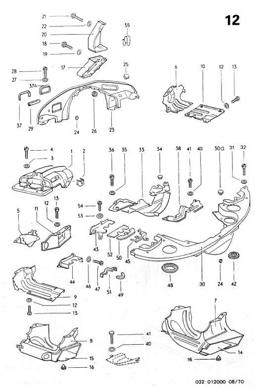

anyone have a set of bottom tins for a 1600?
#6, #9 and #10

The engine is in? I'm thinking the motor is coming back out to change those tins.....
Re: 1961 Microbus
Heat exchangers are still off, they go under jugs and screw in from bottom.
No?

Mike Kever Kombi wrote:Heat exchangers are still off, they go under jugs and screw in from bottom.
No?
From the top, depending on the front tin might be covered by it too.

Mike, I am sure I have a set or two of the tin you need, and you are welcome to it. I will double check when I get home tonight.
Re: 1961 Microbus
That would be great. Let me know what you come up with.
Re: 1961 Microbus
ive got a set they are pretty crusty thou.Im sure the last thing you want do do is clean them up.. they are only good for a last resort! :roll:
