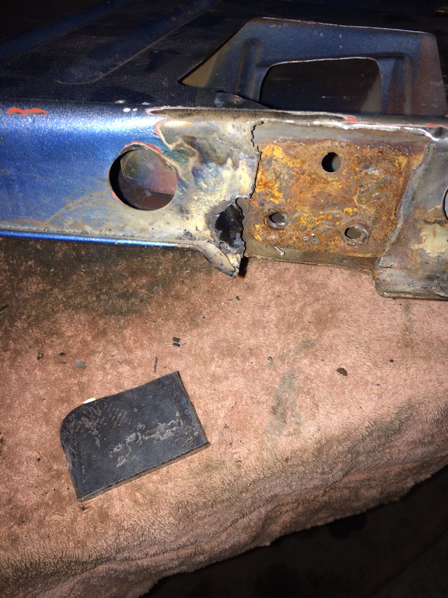

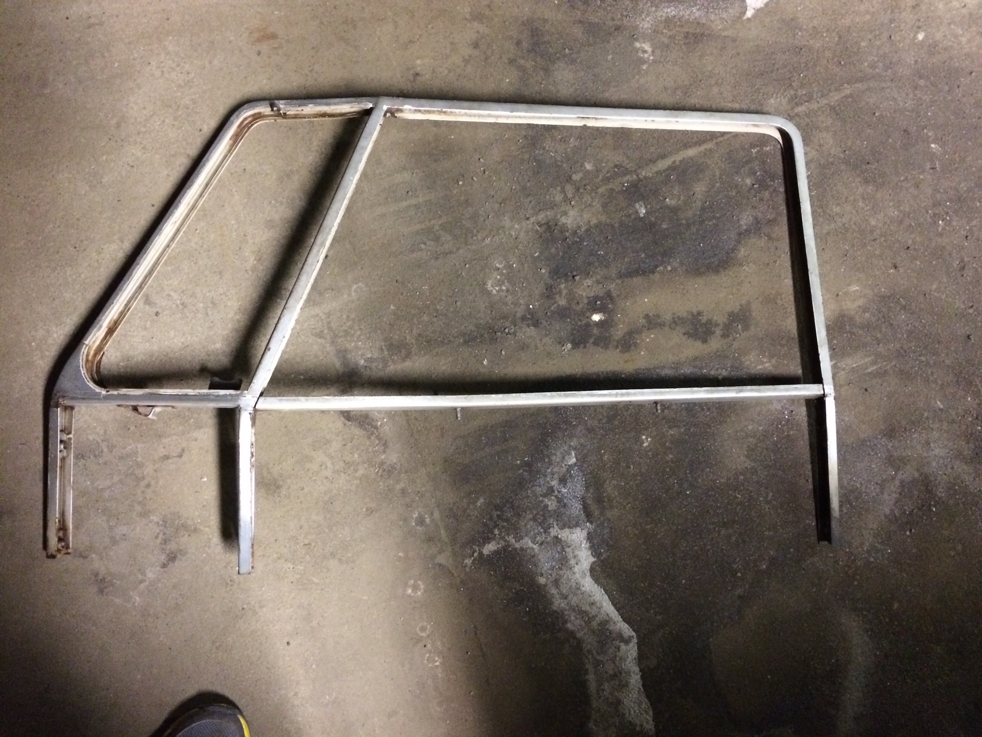

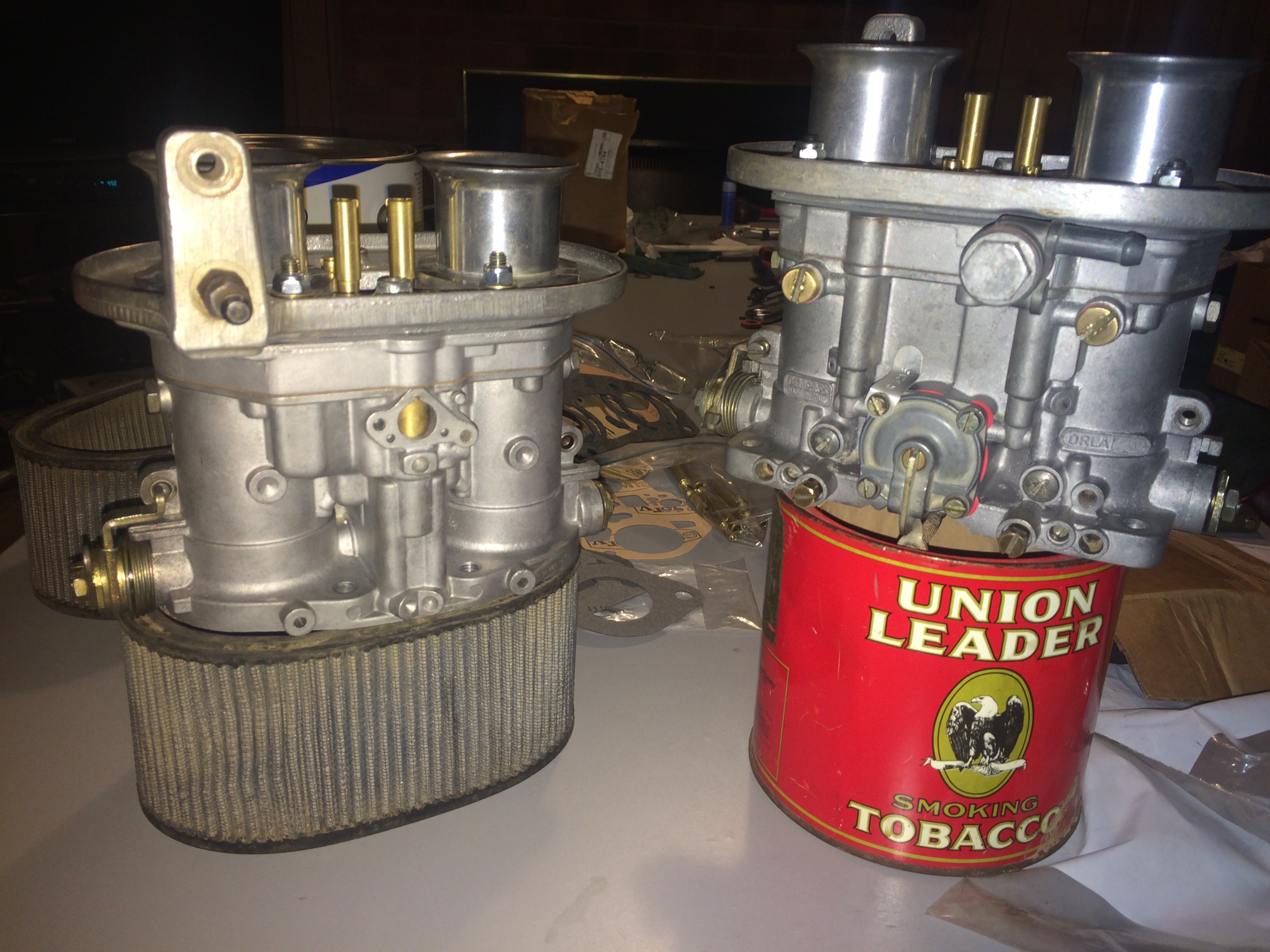

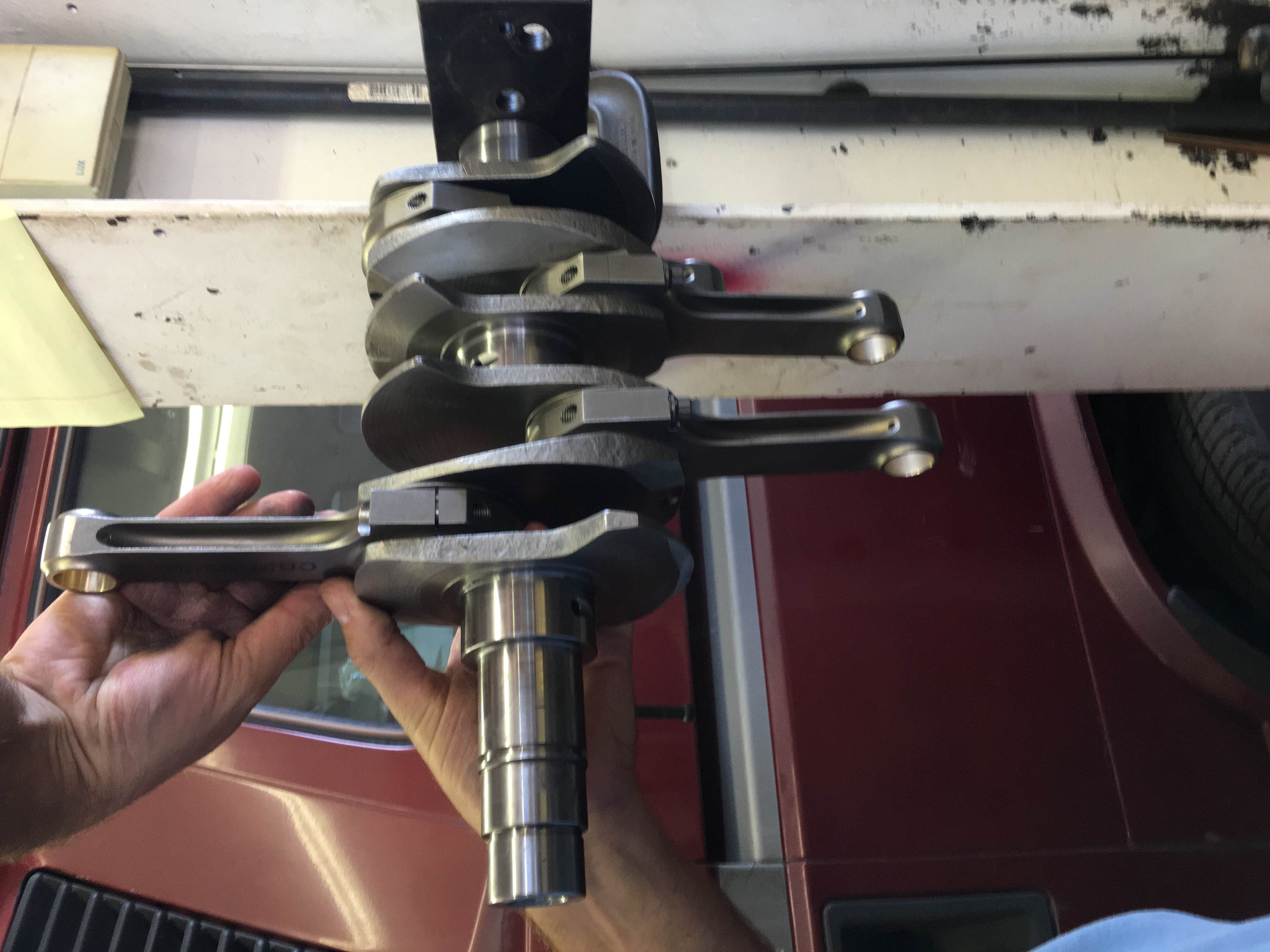

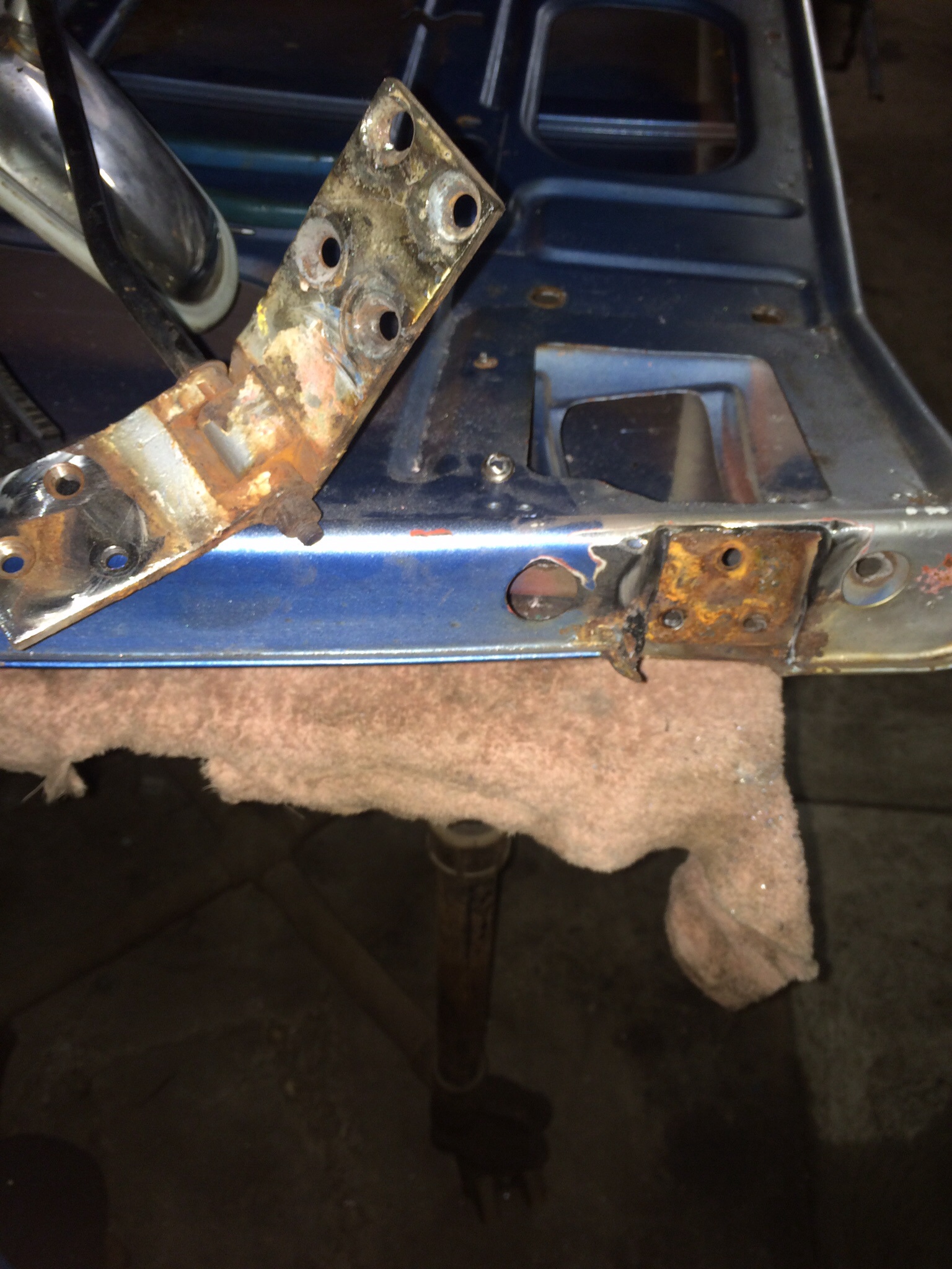

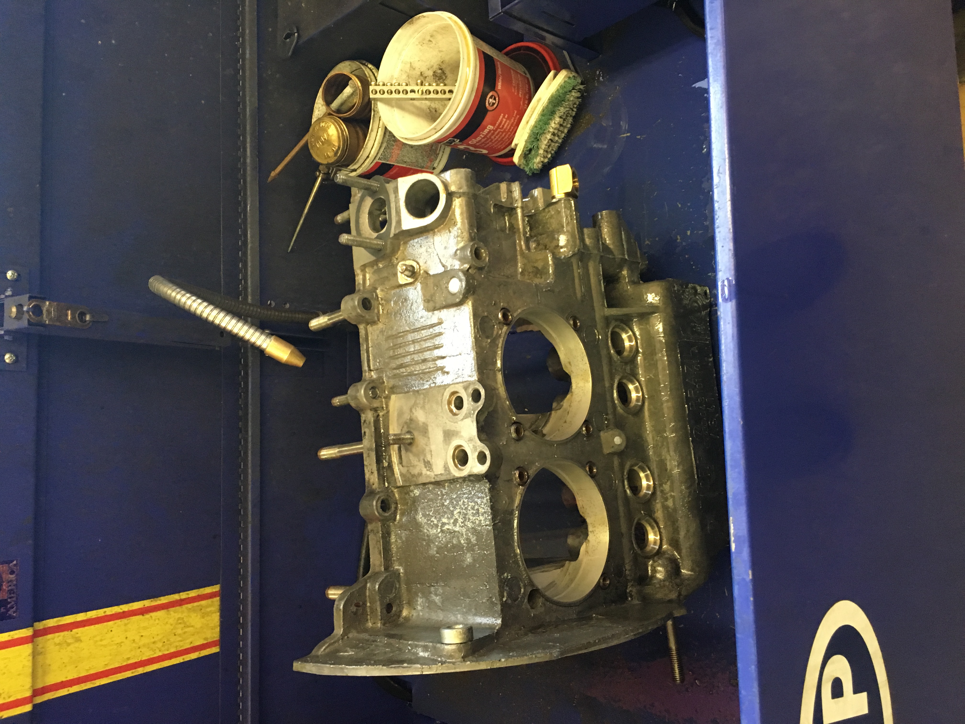

Ive been doing some work lately. Ive been busy doing some window and rubber work. I purchased door rubber kits from WW and Im looking forward to having properly locking vent windows and watching water NOT dribble in :) . I also started trying to fix a PO's door hinge mess... And finally, I started the process of building a 1904cc (74*90.5) motor. I took the case to RIS to be machined up and he was quite pleased with the case unlike some people... Im still on the fence about using stock-like heads and heater boxes or stepping up and getting bigger valved heads and a larger exhaust without heater boxes. I will be going full flow oil for a remote oil filter and a small 1.5 qt sump. Also using the set or Dellorto DRLA 40s that I completely rebuilt. Which gave me a few headaches keeping track of every little part...

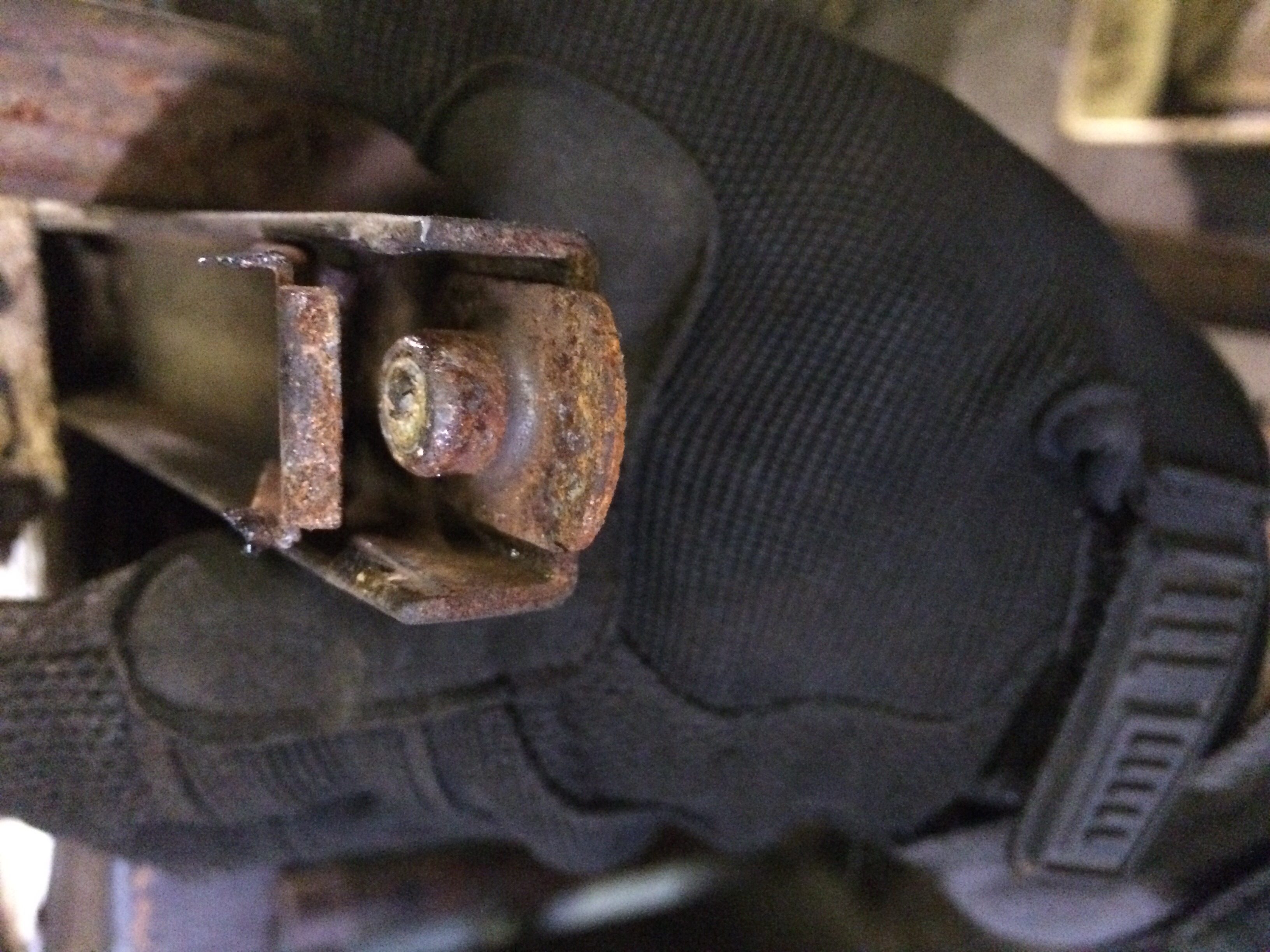

The frame with that came with the bus and broken bolt :)
Cut the welds and pulled it out
tacked in the donor
tacked in the donor

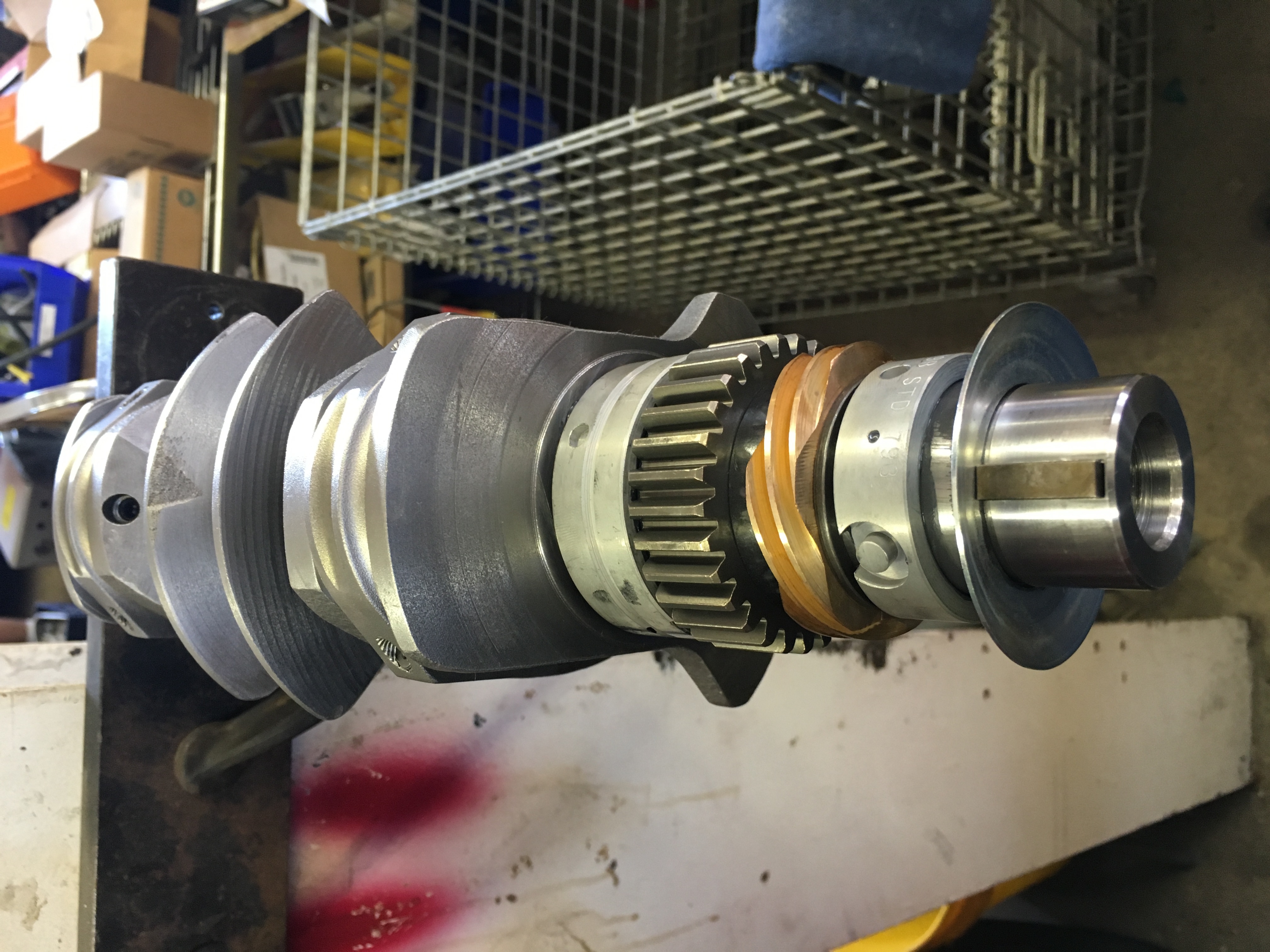

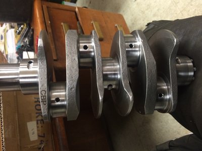

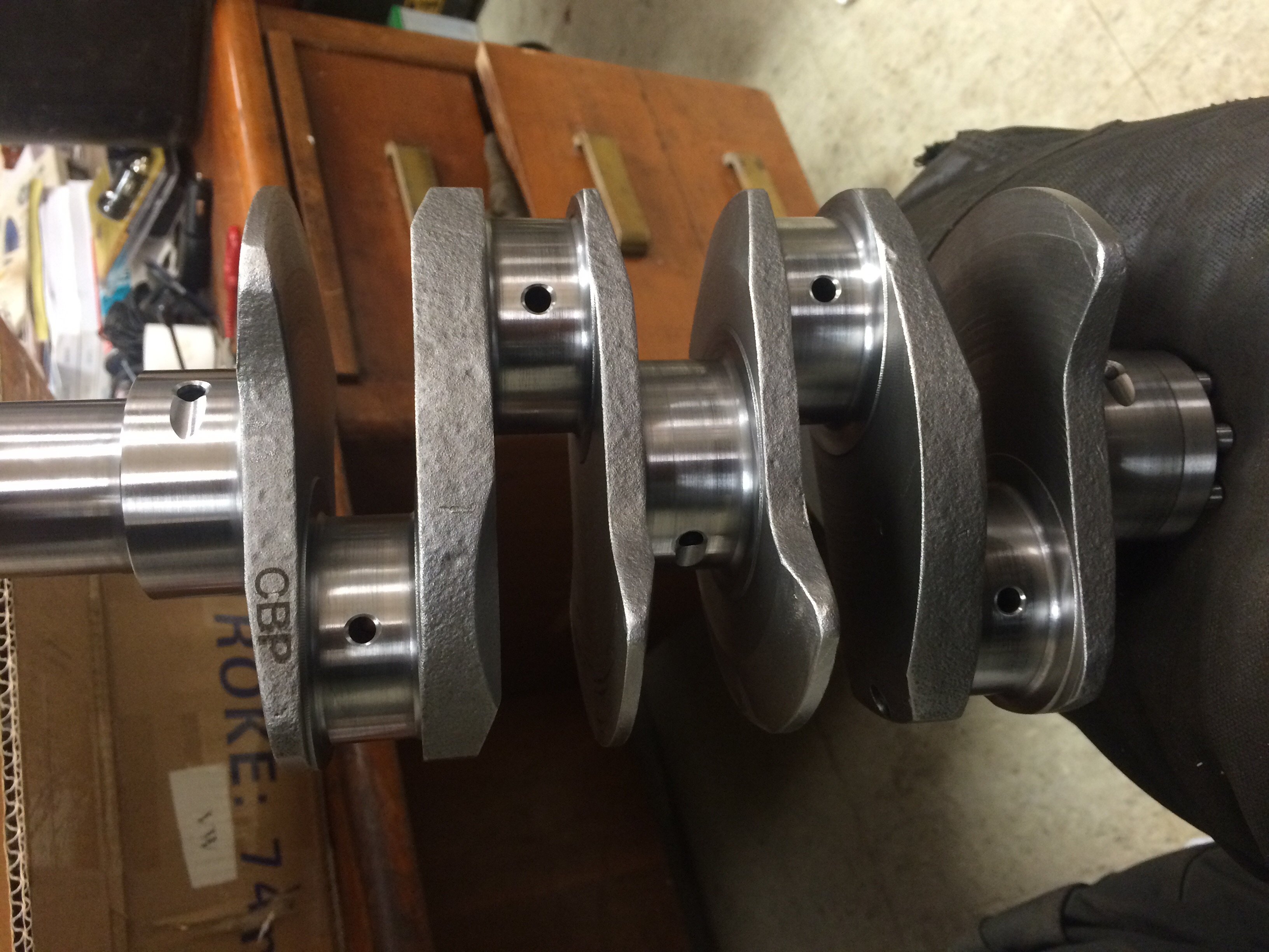

74mm crank :)
74mm crank :)

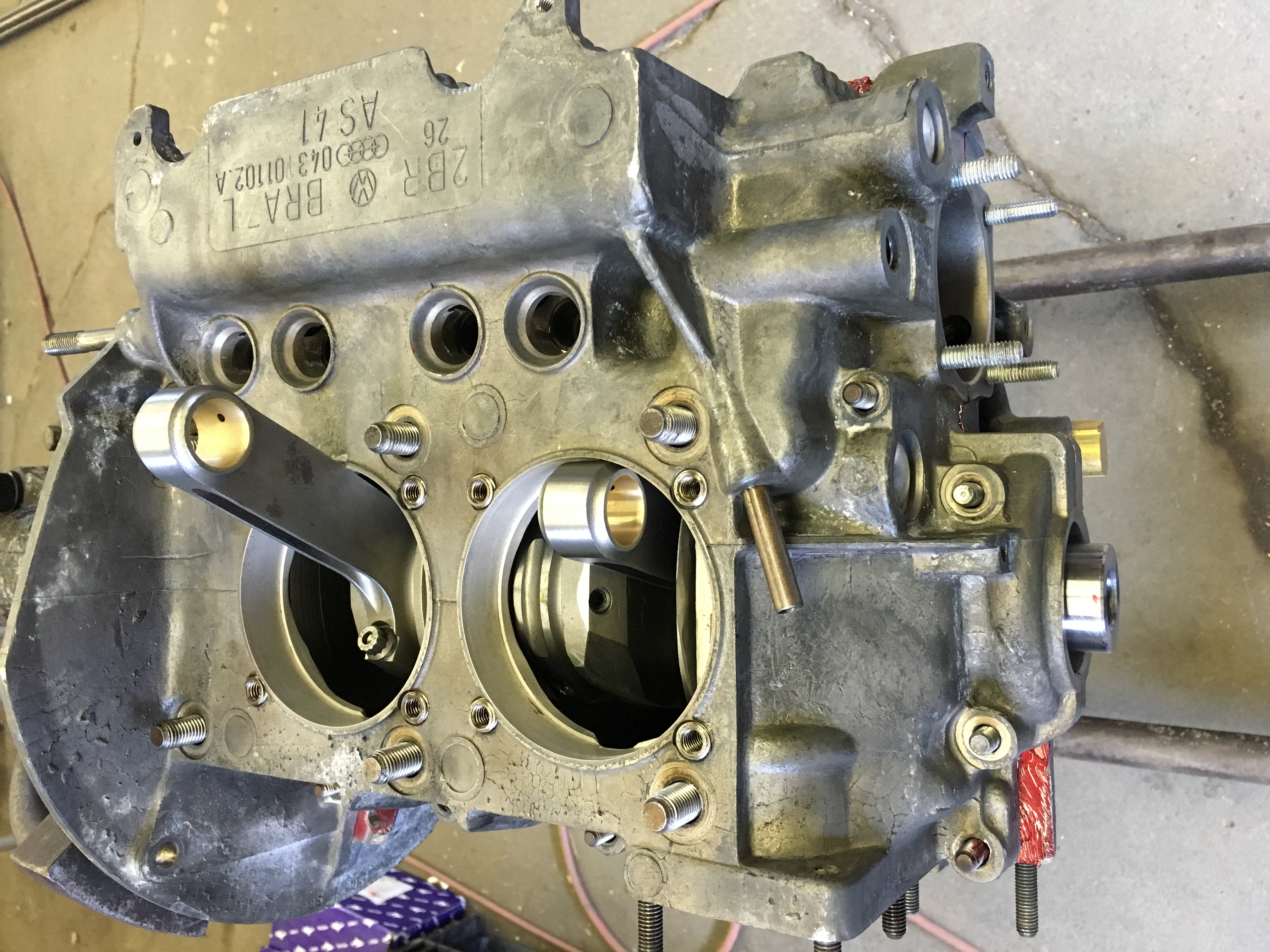

Totally rebuilt Dells...

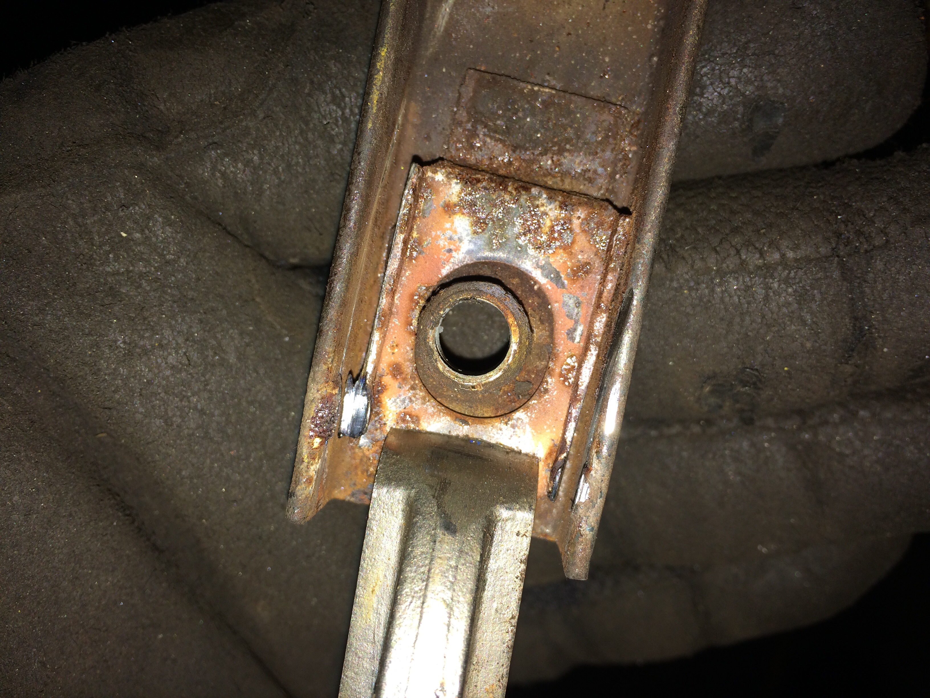

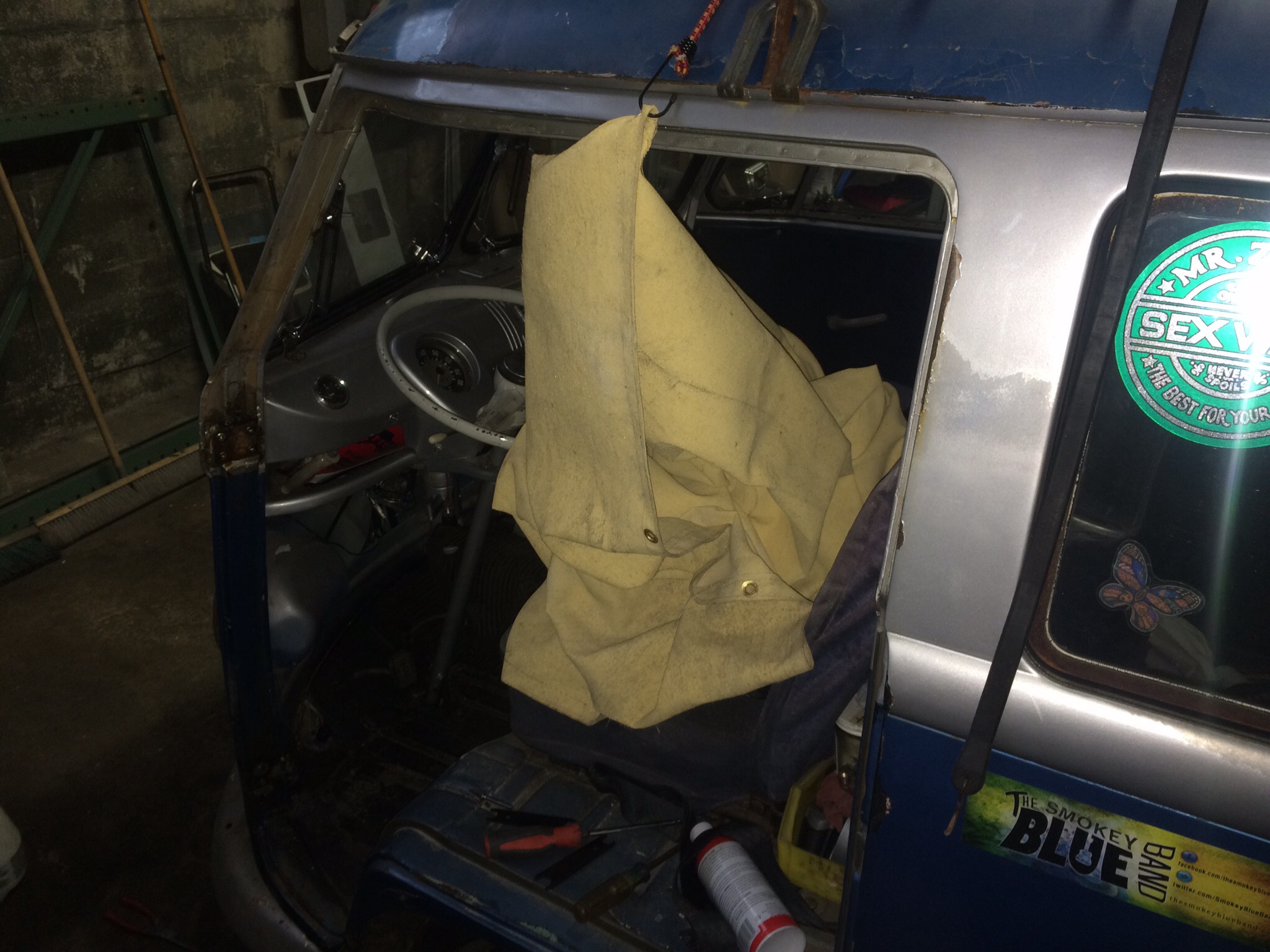

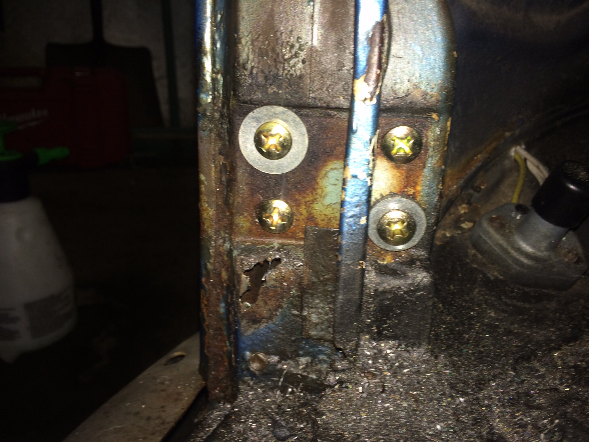

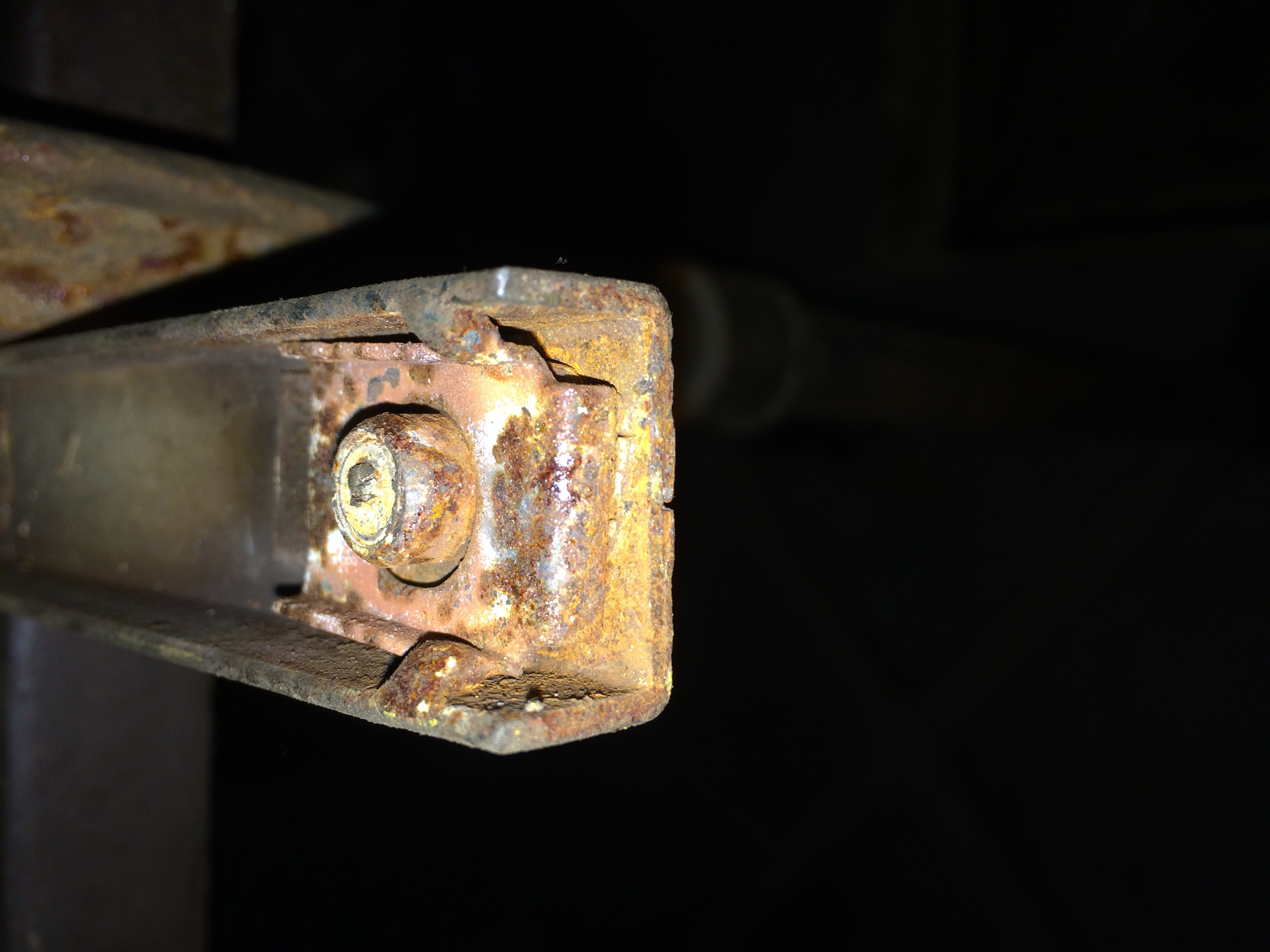

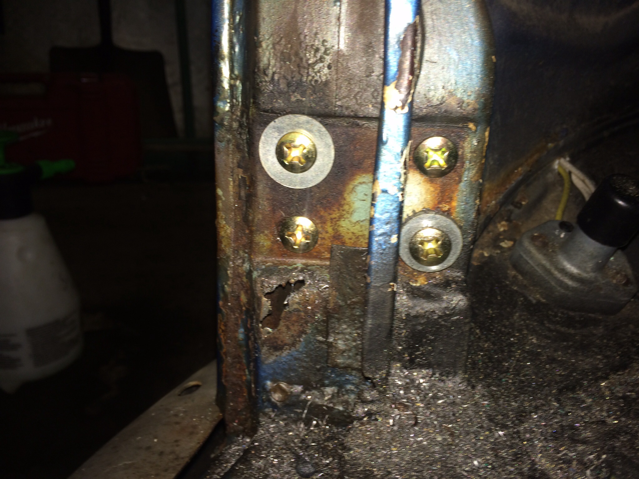

So I've been doing body work and.... I hate it. I would like to thank WSD (west side dan) for helping me get the door off. He held the light and laughed while I kept muttering curse words. After the long process of drilling out broken screws by a PO I did save all 8 threaded holes. Now im just patching up the door and Im almost done with the restoring the window frame assembly with new rubber. Im following this samba thread from the split bus FAQs to save the otherwise nice door. http://www.thesamba.com/vw/forum/viewtopic.php?t=546124
Door finally off...
Door finally off...
What a fight...
What a fight...
Drilled out the 3 rivets that hold the hinge on and got the whole hinge off.
Cut the bad crap out and weld in a new stronger peice

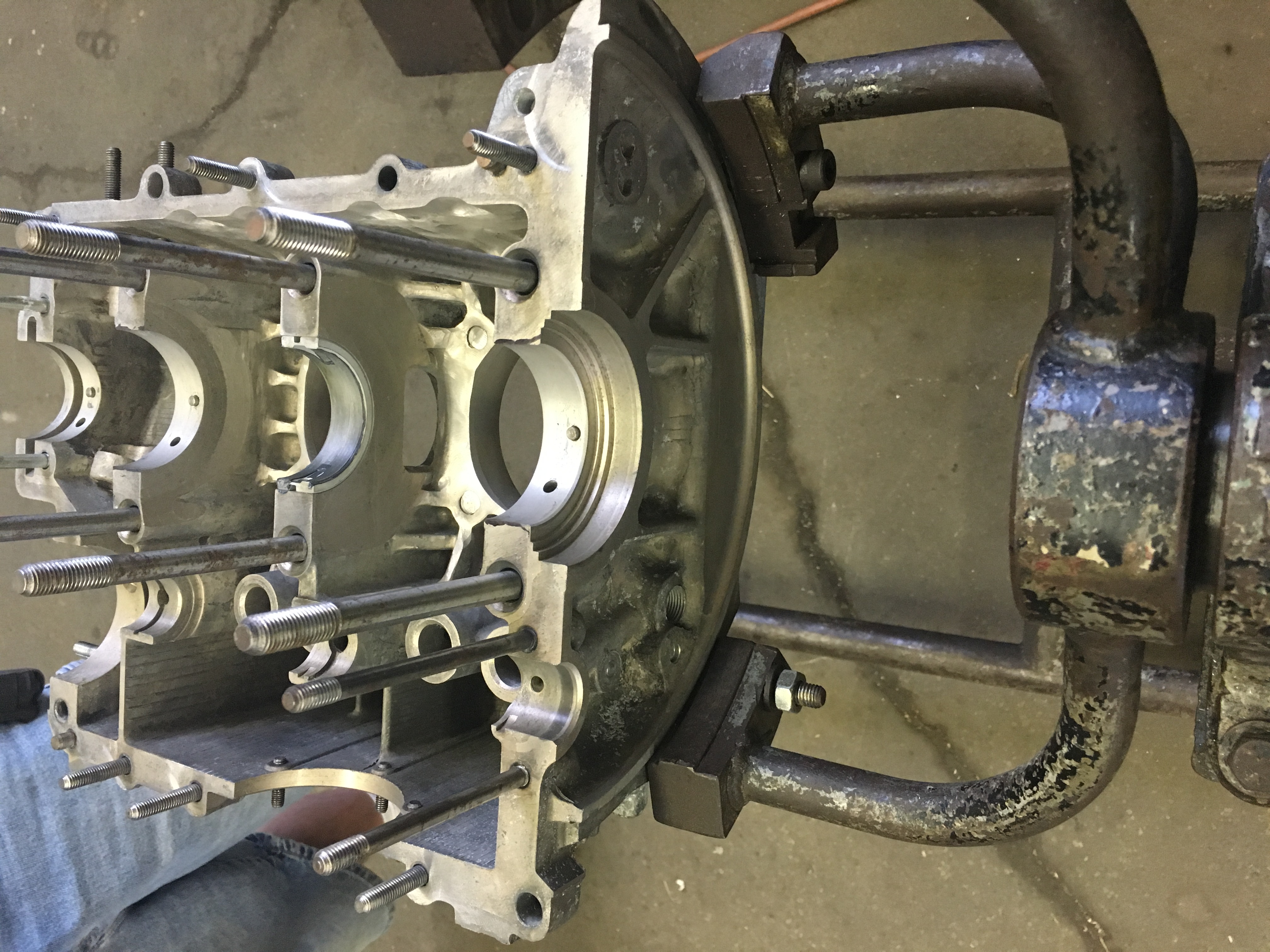

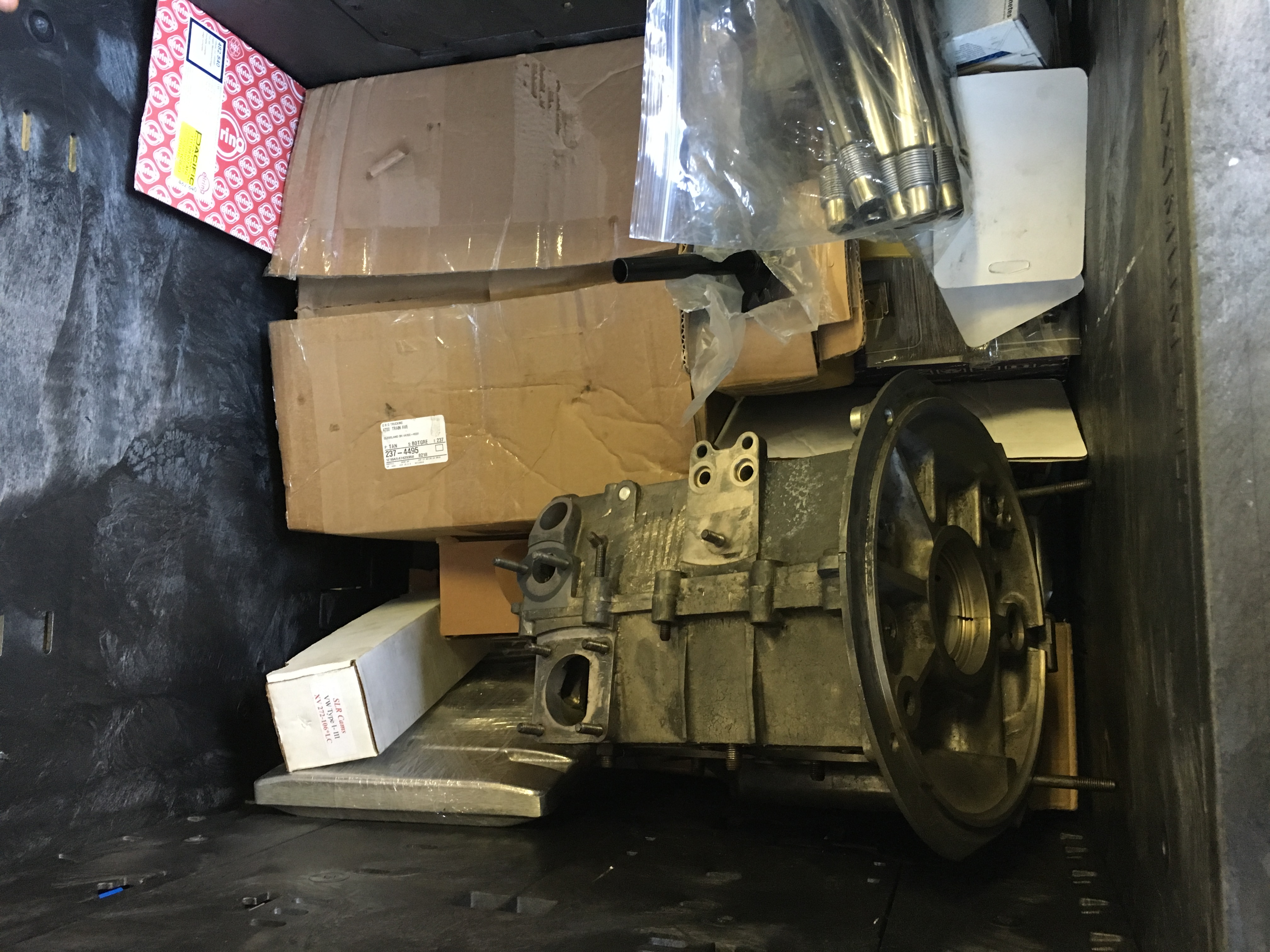

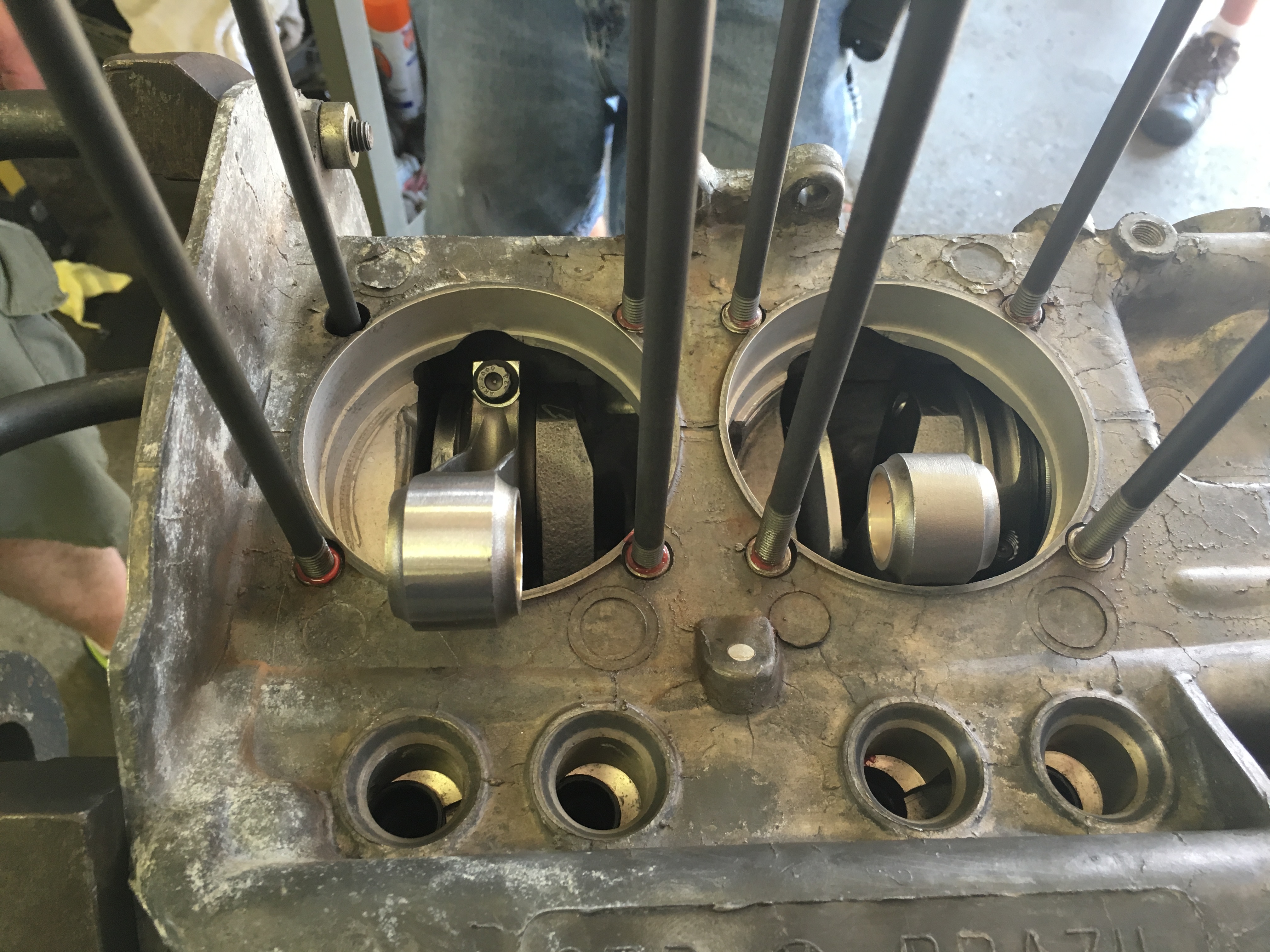

After a break from the hobby for a while. Im getting back on this project. I had my engine parts balanced and Chuck and I have started building. I did some parts cleaning and then We did a super quick mock up to check deck height, internal clearances, and getting some compression numbers of 9:1. I have to order a set of shims to bring it down closer to 8:1. More to follow soon.

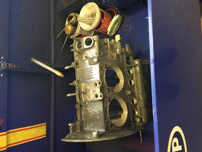

Bin O'Parts
Bin O'Parts

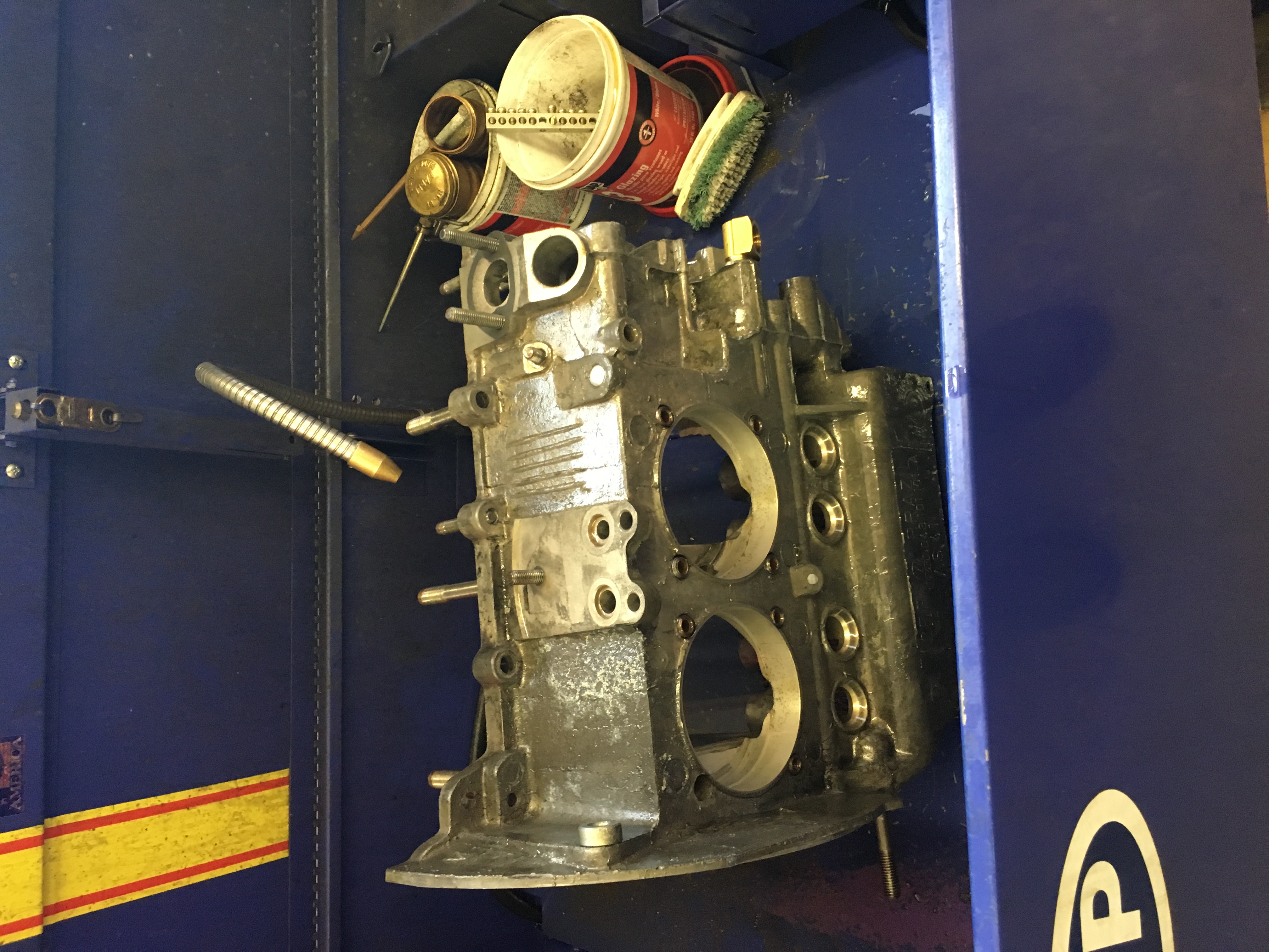

Cleaning again
Cleaning again
On the famous "Spence stand"

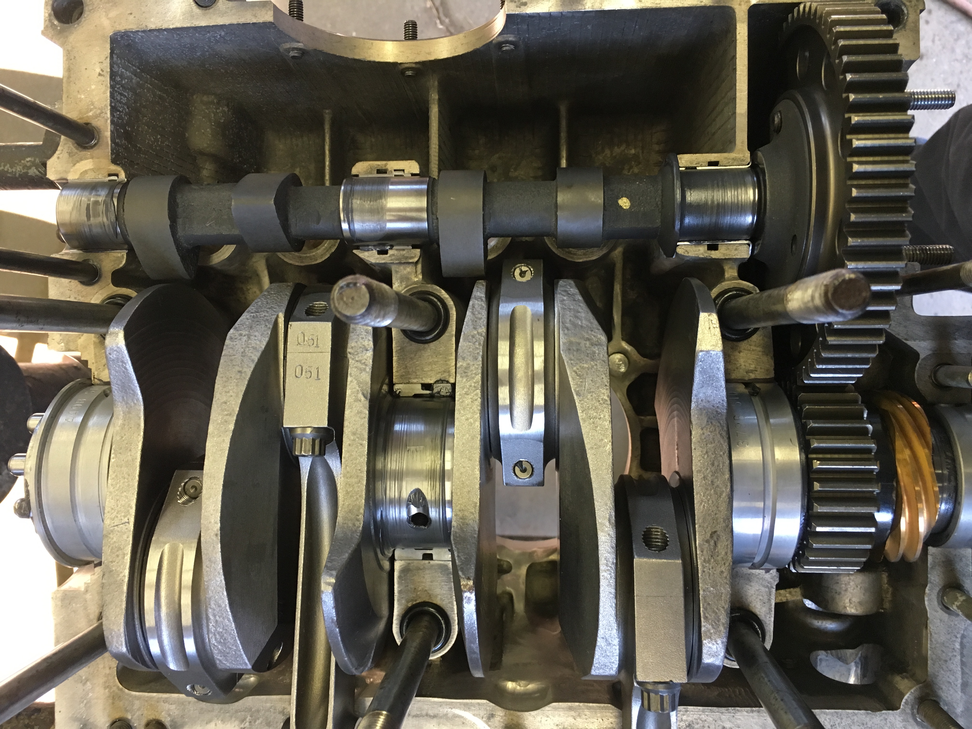

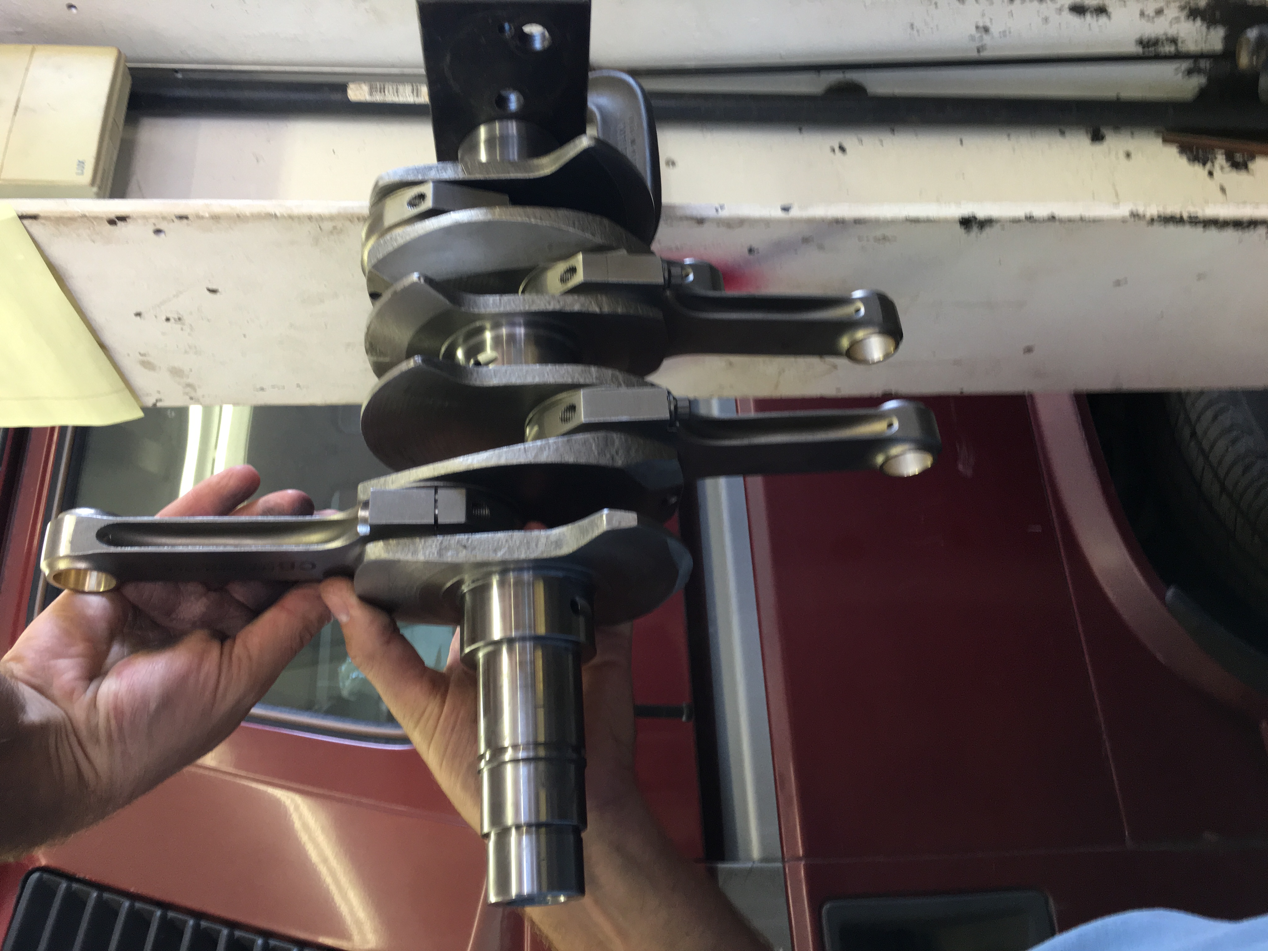

More progress and pictures. Had a little hiccup with my CB Performance cam gear kit. One of the 3 bolts to hold the gear to the cam was shorter than the other 2. Not sure whose bright idea that was... But a replacement bolt will be aqquired tomorrow.
Assembling rods. "Bearing tangs down Rick!!!"-C. Spence
Crank finshed off with bearings, cam and timing gears, and oil slinger.
Crank and cam installed

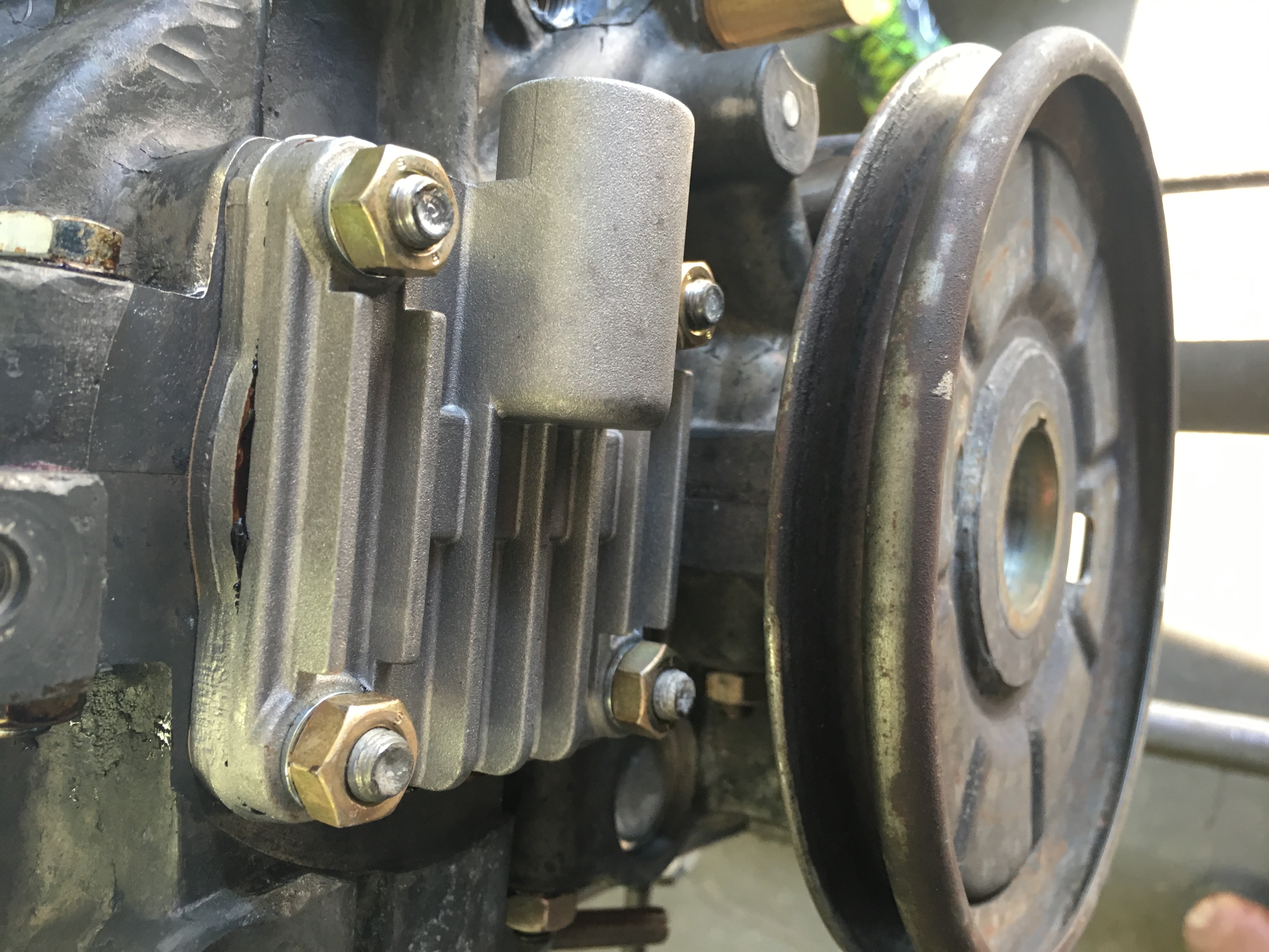

Oil pump and full flow cover installed
