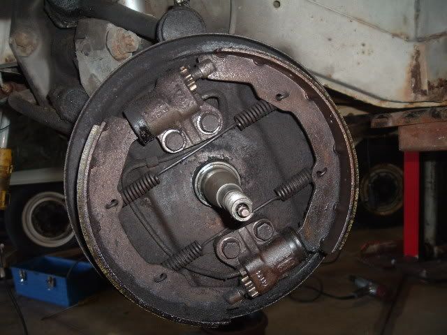

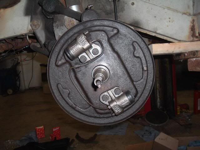

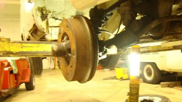

Reg's '67 Westy would pull to the right during hard braking. We pulled both front drums and found both left wheel cylinders were leaking badly and the shoes were soaked with brake fluid. The right side wheel cylinders and linings were dry but badly worn. Time for a front brake job. :shock: :o :o . Here we go again. :roll:

Also replaced the fuel filter, tail pipe and lubed the front end.
