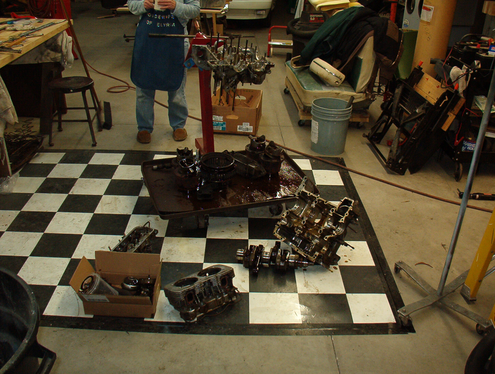

A few pics. After teardown,began to inspect.

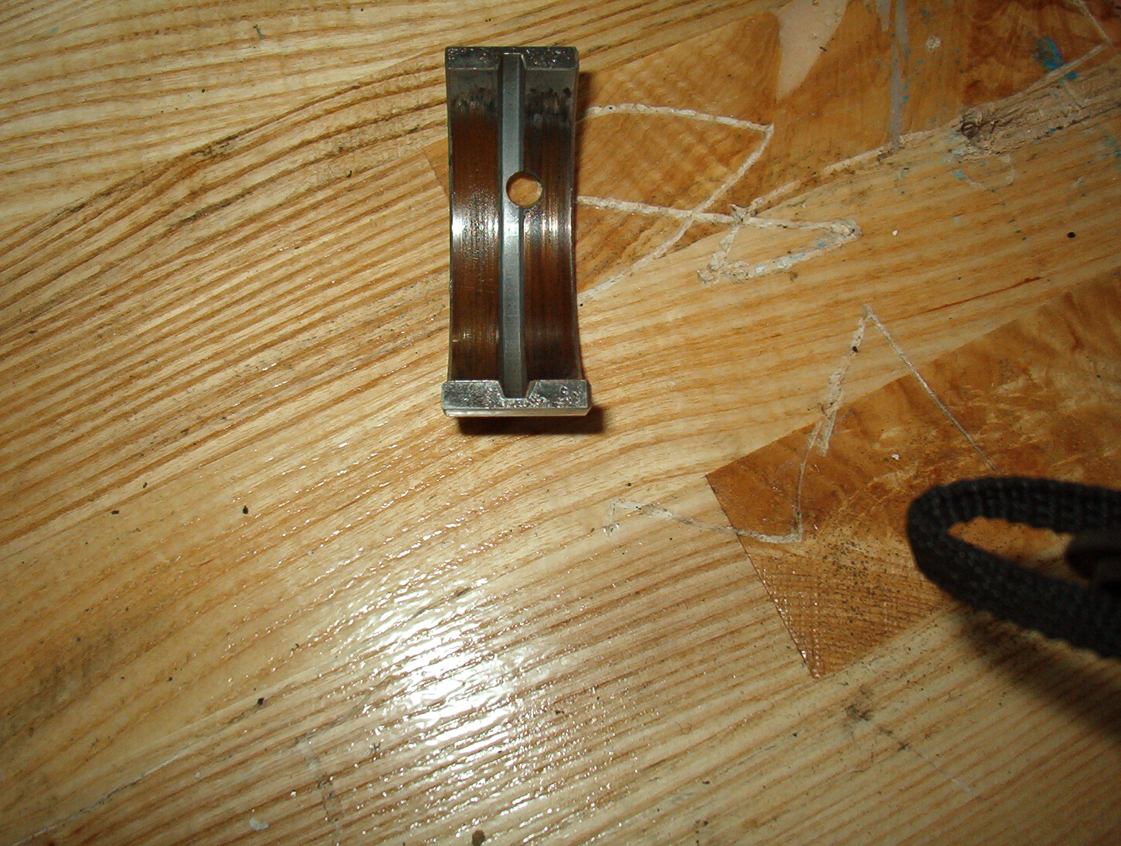

Center main bearing looked like this.
Also was sloppy in the bearing saddle and dowel hole was ovaled . This bearing was definitly moving.
At first I thought that the case would need align bored. Took a NEW standard bearing and it fit nice and tight. Looks like the back side of the bearing took the beating.
